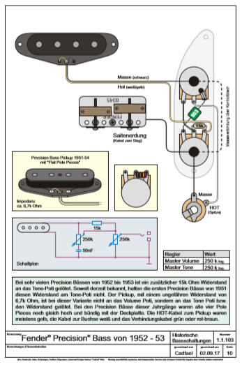

  • Wiring has been changed to 55 specs (some 54 were also wired like that) as out of the box it had a significant volume drop when dialing back the tone knob, which was very annoying (some 54 basses were wired like that, others like 55 and onwards). There is a video on YouTube describing that design feature / flaw...

Hi,
I got the pickup wired to the volume pot. It is now “more vintage correct” as the bass has the transition contoured body, but more important, the tone pot can now be used as it doesn’t affect volume.
Originally it was wired to the tone pot as per the attached diagram. Here it says that P basses from 51 to 53 era where wired that way, which to me corresponds to the slap body era:
