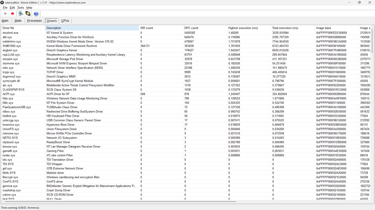

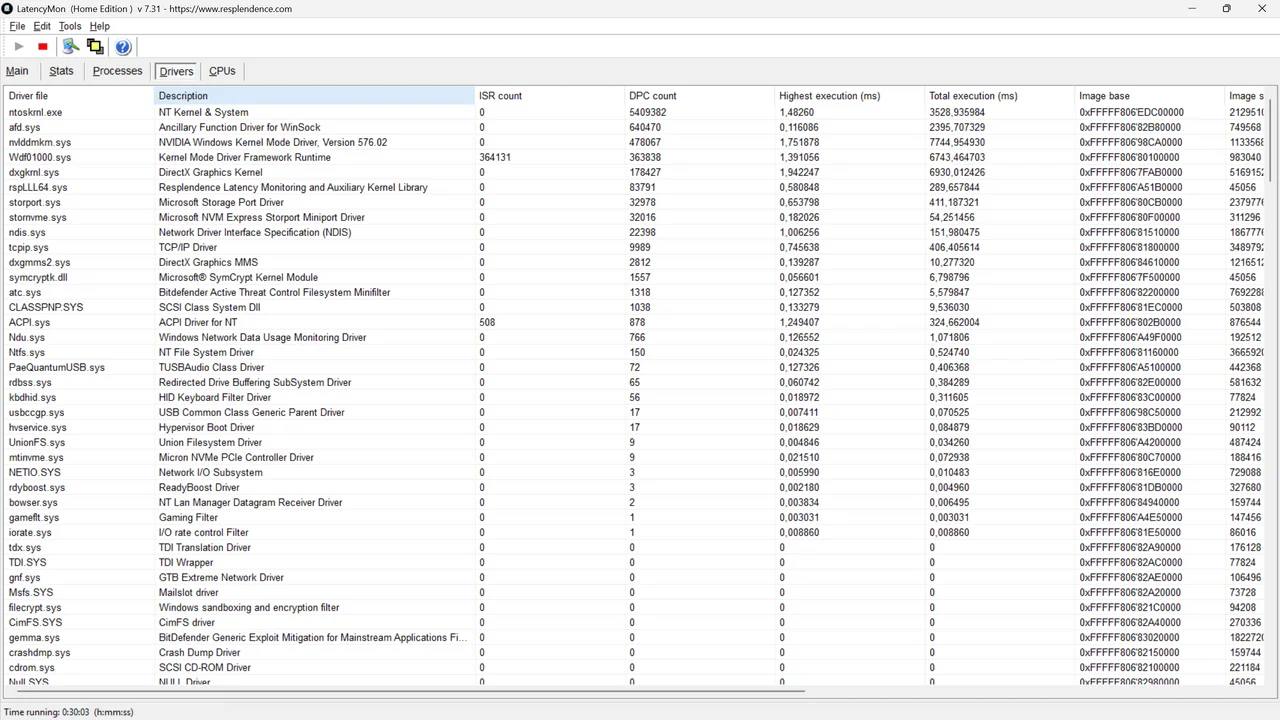

Latencymon result:
_________________________________________________________________________________________________________
CONCLUSION
Your system seems to be having difficulty handling real-time audio and other tasks. You may experience drop outs, clicks or pops due to buffer underruns. One or more DPC routines that belong to a driver running in your system appear to be executing for too long. One problem may be related to power management, disable CPU throttling settings in Control Panel and BIOS setup. Check for BIOS updates.
LatencyMon has been analyzing your system for 0:01:26 (h:mm:ss) on all processors.
SYSTEM INFORMATION
Computer name: RONIN
OS version: Windows 11, 10.0, version 2009, build: 26100 (x64)
Hardware: ROG Zephyrus S17 GX703HRD_GX703HR, ASUSTeK COMPUTER INC.
BIOS: GX703HRD.311
CPU: GenuineIntel 11th Gen Intel(R) Core(TM) i7-11800H @ 2.30GHz
Logical processors: 16
Processor groups: 1
Processor group size: 16
RAM: 32442 MB total
CPU SPEED
Reported CPU speed (WMI): 2304 MHz
Reported CPU speed (registry): 2304 MHz
Note: reported execution times may be calculated based on a fixed reported CPU speed. Disable variable speed settings like Intel Speed Step and AMD Cool N Quiet in the BIOS setup for more accurate results.
MEASURED INTERRUPT TO USER PROCESS LATENCIES
The interrupt to process latency reflects the measured interval that a usermode process needed to respond to a hardware request from the moment the interrupt service routine started execution. This includes the scheduling and execution of a DPC routine, the signaling of an event and the waking up of a usermode thread from an idle wait state in response to that event.
Highest measured interrupt to process latency (µs): 1264,70
Average measured interrupt to process latency (µs): 11,149151
Highest measured interrupt to DPC latency (µs): 1246,10
Average measured interrupt to DPC latency (µs): 4,577375
REPORTED ISRs
Interrupt service routines are routines installed by the OS and device drivers that execute in response to a hardware interrupt signal.
Highest ISR routine execution time (µs): 364,299479
Driver with highest ISR routine execution time: ACPI.sys - ACPI Driver for NT, Microsoft Corporation
Highest reported total ISR routine time (%): 0,003025
Driver with highest ISR total time: Wdf01000.sys - Kernel Mode Driver Framework Runtime, Microsoft Corporation
Total time spent in ISRs (%) 0,003160
ISR count (execution time <250 µs): 78066
ISR count (execution time 250-500 µs): 0
ISR count (execution time 500-1000 µs): 1
ISR count (execution time 1000-2000 µs): 0
ISR count (execution time 2000-4000 µs): 0
ISR count (execution time >=4000 µs): 0
REPORTED DPCs
DPC routines are part of the interrupt servicing dispatch mechanism and disable the possibility for a process to utilize the CPU while it is interrupted until the DPC has finished execution.
Highest DPC routine execution time (µs): 1391,056424
Driver with highest DPC routine execution time: Wdf01000.sys - Kernel Mode Driver Framework Runtime, Microsoft Corporation
Highest reported total DPC routine time (%): 0,123417
Driver with highest DPC total execution time: Wdf01000.sys - Kernel Mode Driver Framework Runtime, Microsoft Corporation
Total time spent in DPCs (%) 0,210290
DPC count (execution time <250 µs): 278922
DPC count (execution time 250-500 µs): 0
DPC count (execution time 500-10000 µs): 60
DPC count (execution time 1000-2000 µs): 1
DPC count (execution time 2000-4000 µs): 0
DPC count (execution time >=4000 µs): 0
REPORTED HARD PAGEFAULTS
Hard pagefaults are events that get triggered by making use of virtual memory that is not resident in RAM but backed by a memory mapped file on disk. The process of resolving the hard pagefault requires reading in the memory from disk while the process is interrupted and blocked from execution.
NOTE: some processes were hit by hard pagefaults. If these were programs producing audio, they are likely to interrupt the audio stream resulting in dropouts, clicks and pops. Check the Processes tab to see which programs were hit.

schnapp dir https://www.resplendence.com/latencymon und lerne die einzelnen ausgaben zu bewerten, der farbige balken auf dem ersten tab ist nur show, details findest du weiter hinten unter den weiteren tabs. eine herangehensweise ist, alles, was nicht wirklich benötigt wird, im bios zu deaktivieren, ein frisches windows inkl treiber und updates ohne weiteren firlefanz zu installieren und dann schrittweise die störenfriede mit latencymon ausfindig zu machen und diese gezielt entweder über andere treiber (auch ältere) oder über die manuelle vergabe von systemresourcen gefügig zu machen. dazu systematisch ein problem nach dem anderen mit jeweils zwischenmessungen mit latencymon angehen. dokumentieren nicht vergessen (um auch sackgassen wieder verlassen zu können, die nicht gebracht haben).

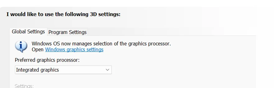

  • #30
kannst du die nvidia-grafik deaktivieren und mit der grafik der cpu nochmal messen?
Ist deaktiviert! Die messungen oben sind Intel GPU-only

ich sehe da noch immer einen nvidia-treiber.
Hmmm ... dann müsste ich im BIOS abschalten.
Bedeutet: ich kann die NVIDIA GPU nicht zum Rendern nutzen. Ansich kein Problem, aber wäre schön, wenn ich dafür nicht immer booten müsste.
