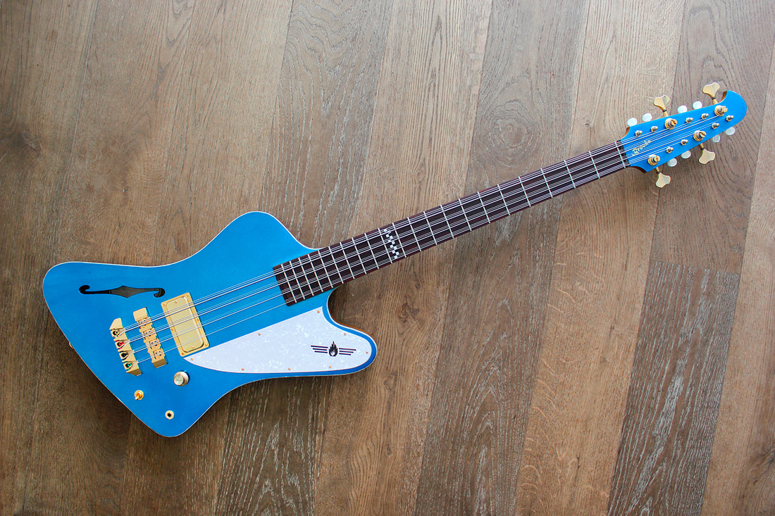

Hier ist der Brooks SparkleBird

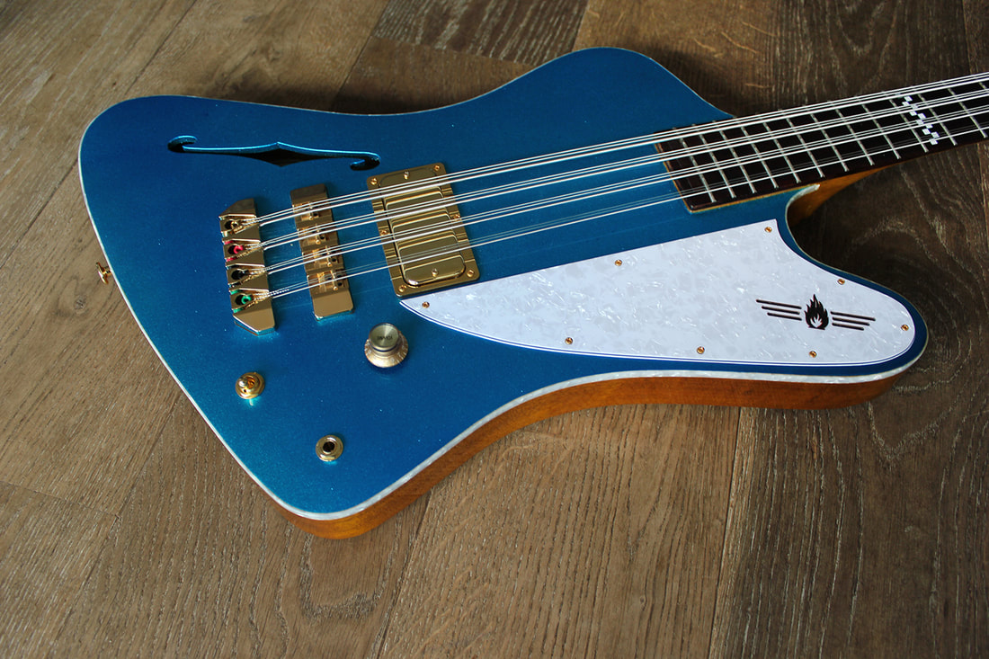

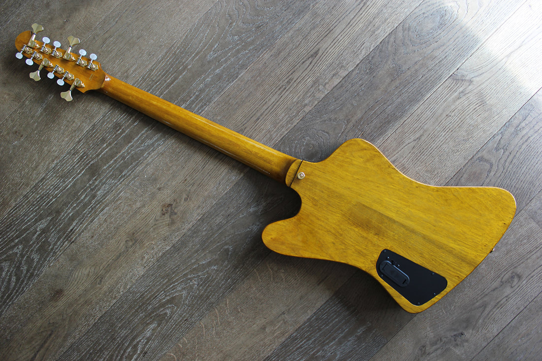

- Body: Korina. Chambered. Thunderbird shape
- Neck: Korina three piece. Glued in.
- Two spokewheel truss rods. One carbon stiffening rod

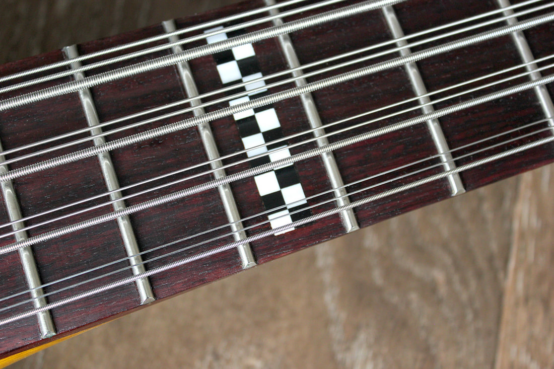

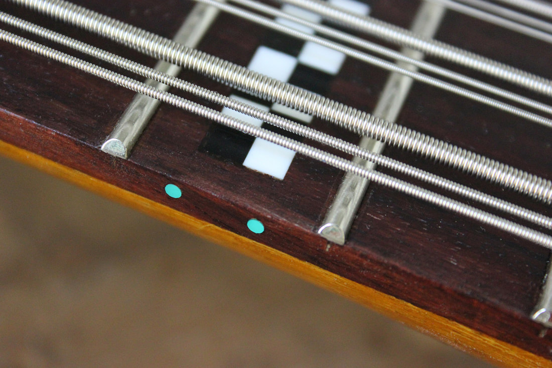

- Fretboard: Rosewood. Checkerboard inlay on 12th
- Luminlay side markers (blue)
- Frets: Jumbo size. Sintoms. Nickel-silver
- Scale: 34”
- Top Nut: Buffalo horn

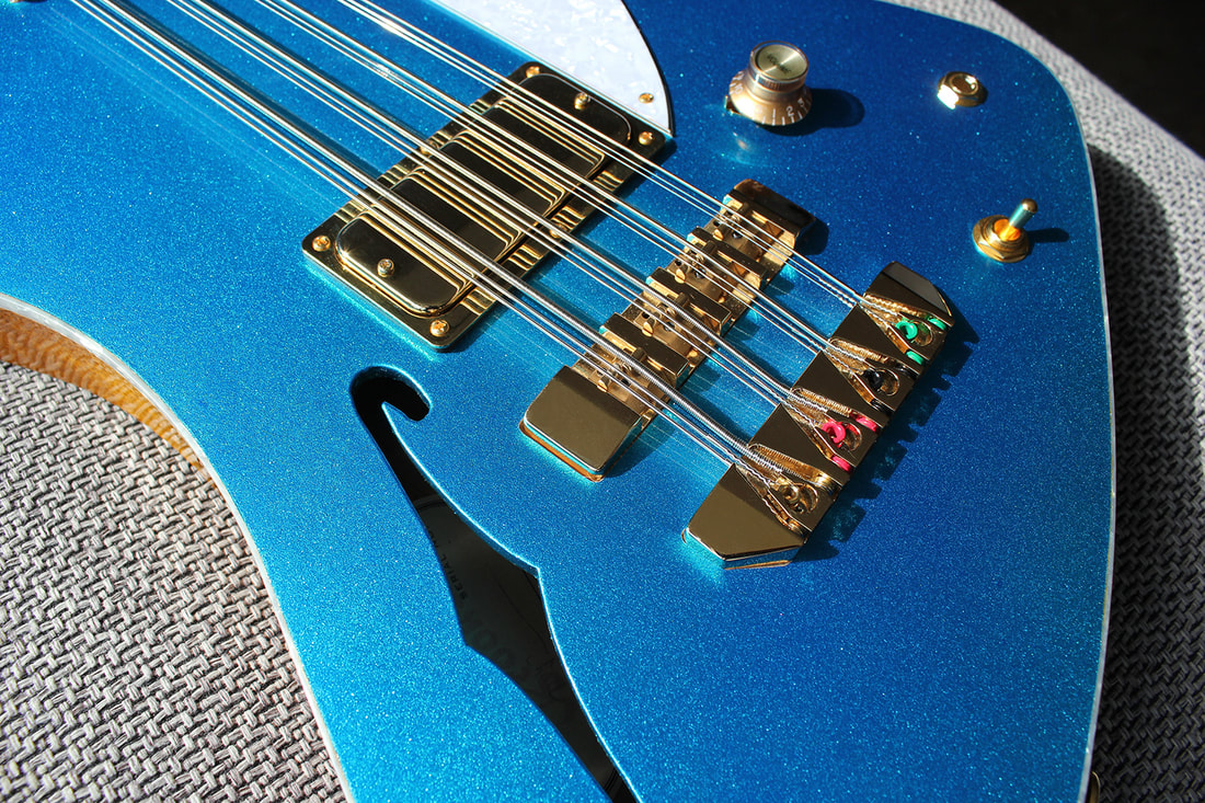

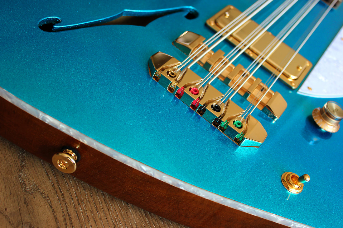

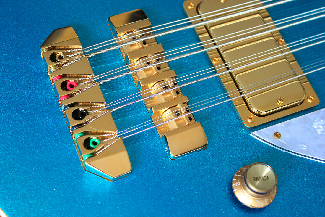

- Bridge: ETS twelve string bridge set. Gold

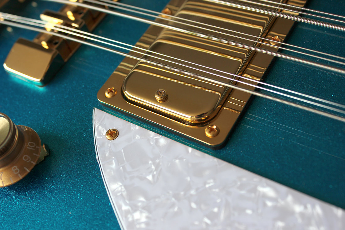

- Pickup: Gemini Dominator TB Pickup. Gold
- Output: PureTone 1/4 inch Jack. Gold plated

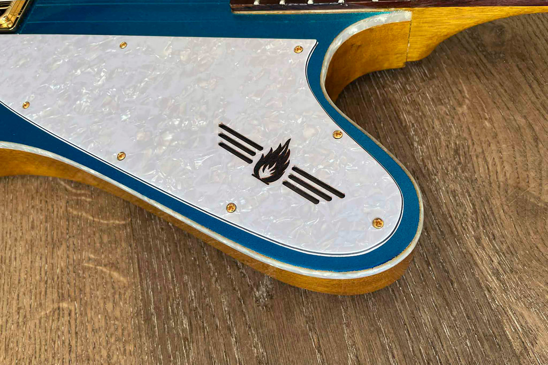

- Controls: Volume . Kill switch

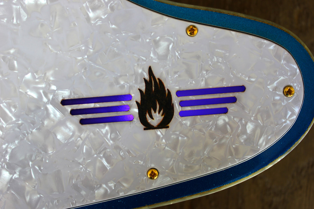

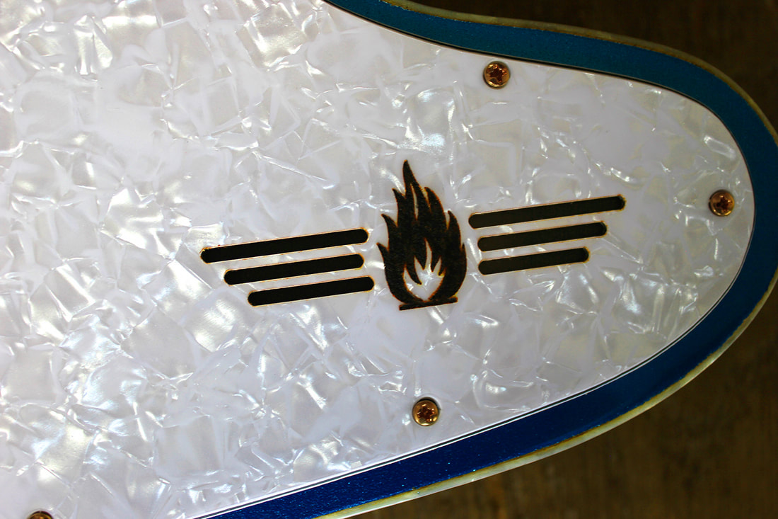

- Pickguard: Pearloid with blue led light
- Binding: Pearloid

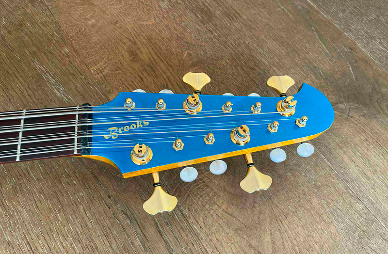

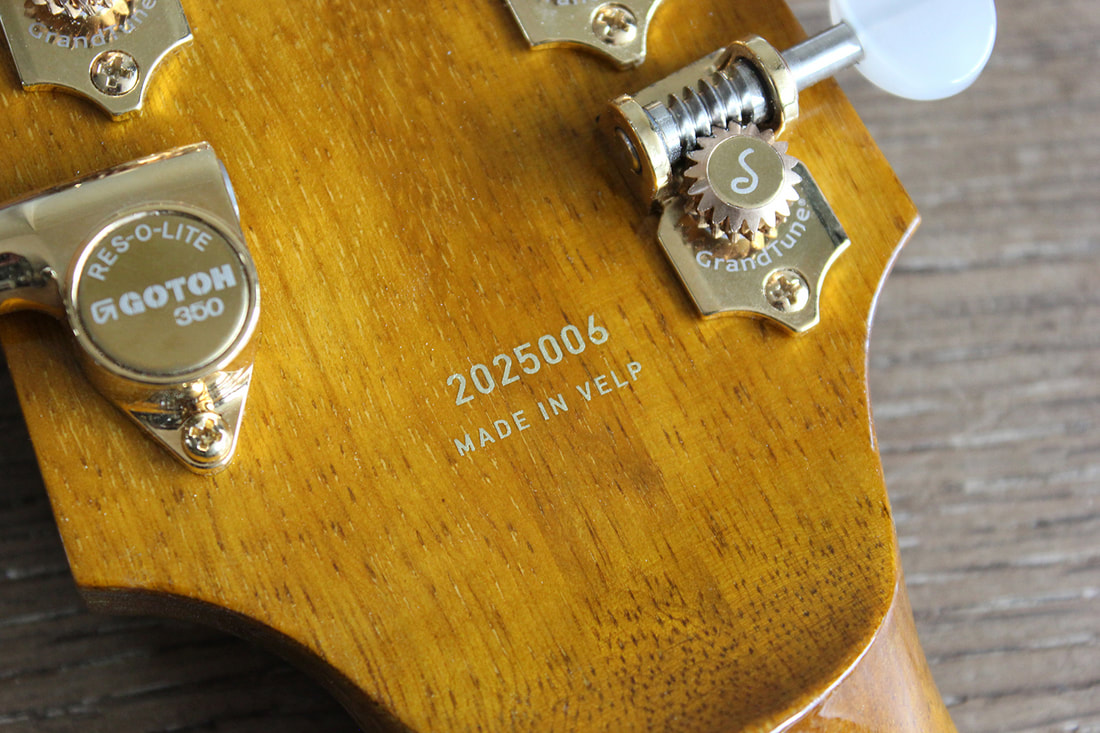

- Bass string tuners: Gotoh Res-o-lite GB350. Gold
- Octave tuners: Schaller Grand tune Gold. Pearloid buttons
- Strings: d’Addario. 170-12
- Strapnuts: Large, Gold
- Finish top: Cobalt Blue Candy
- Finish back and sides: Stained. Finish clear transparent.
- Weight: 4.6 KG
Led light ON
Led Light OFF
