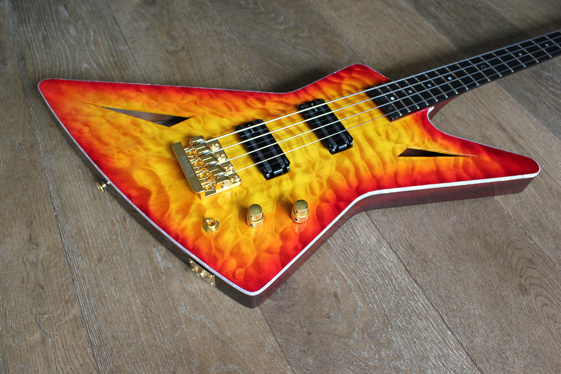

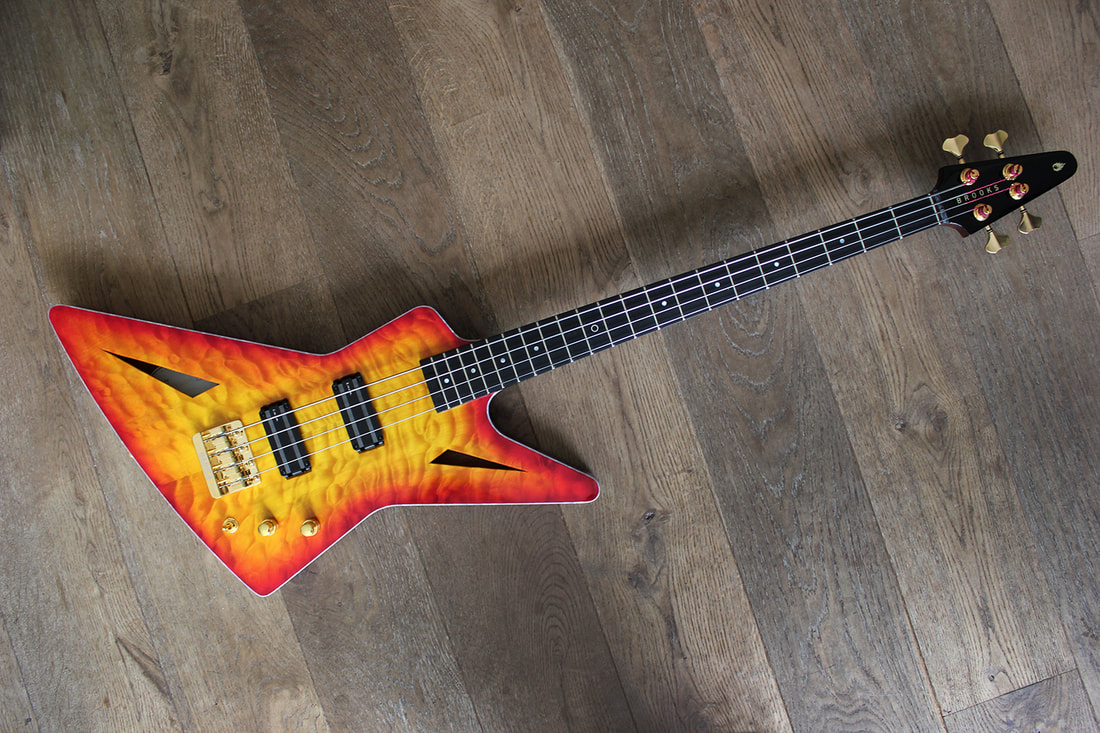

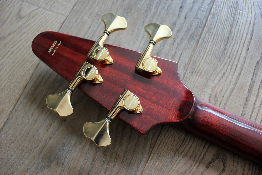

Gestern wurde ein neuer Bass geboren:
Die Brooks EXB-4-SA
Ein halbakustischer Bass in Explorer-Form mit 4 Saiten.
- Mahogany body. Two large tone chambers
- Quilted Maple top, bookmatched

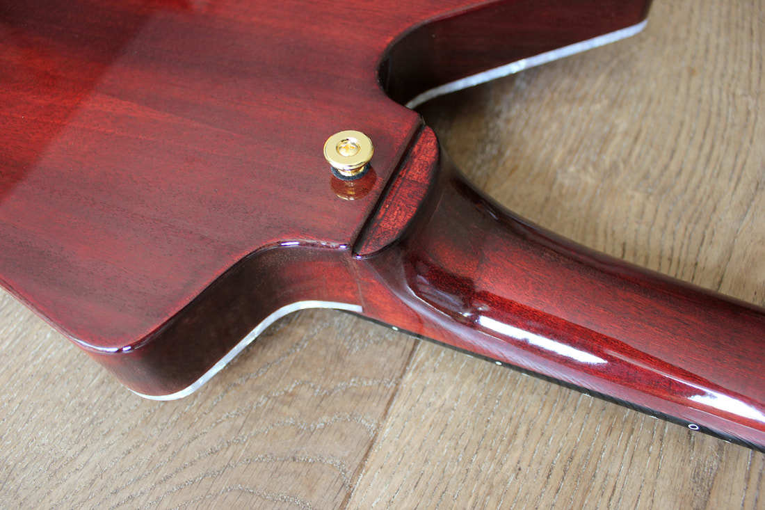

- Three piece Mahogany set neck. Glued in

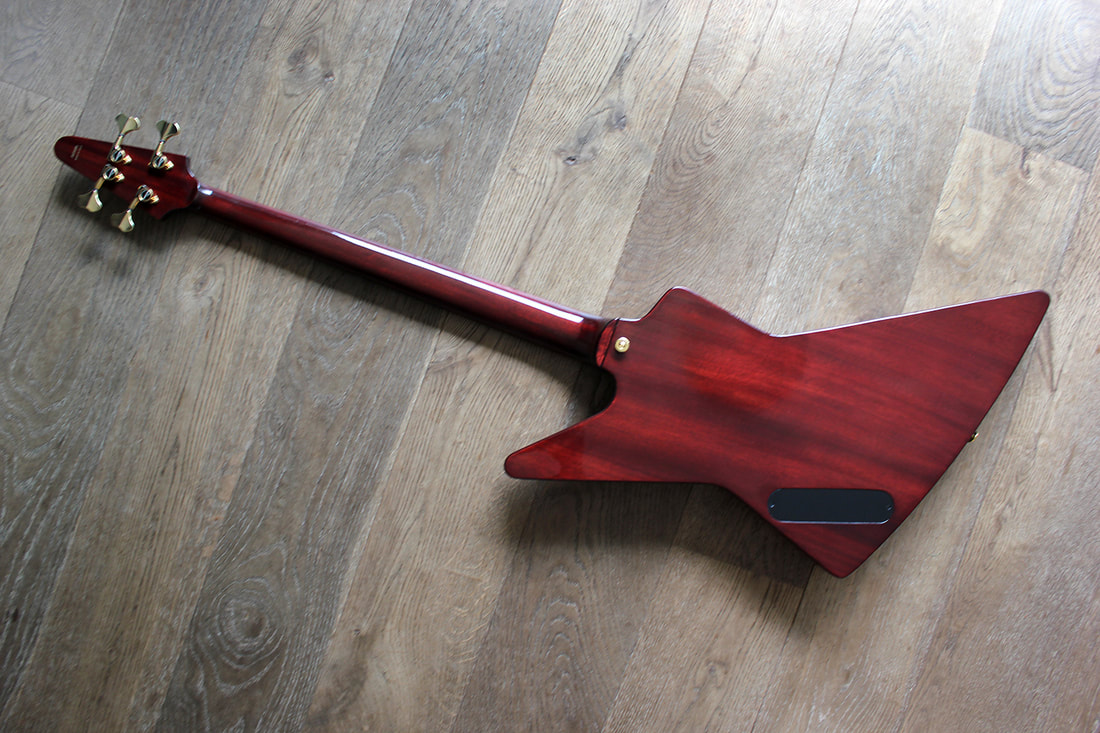

- Cherry Burst finish. Dark Mahogany back and sides
- Pearloid binding
- Ebony fretboard
- Pearl position dots. Aluminium ring in 12th position
- Jumbo frets
- 34" scale
- Buffalo horn nut

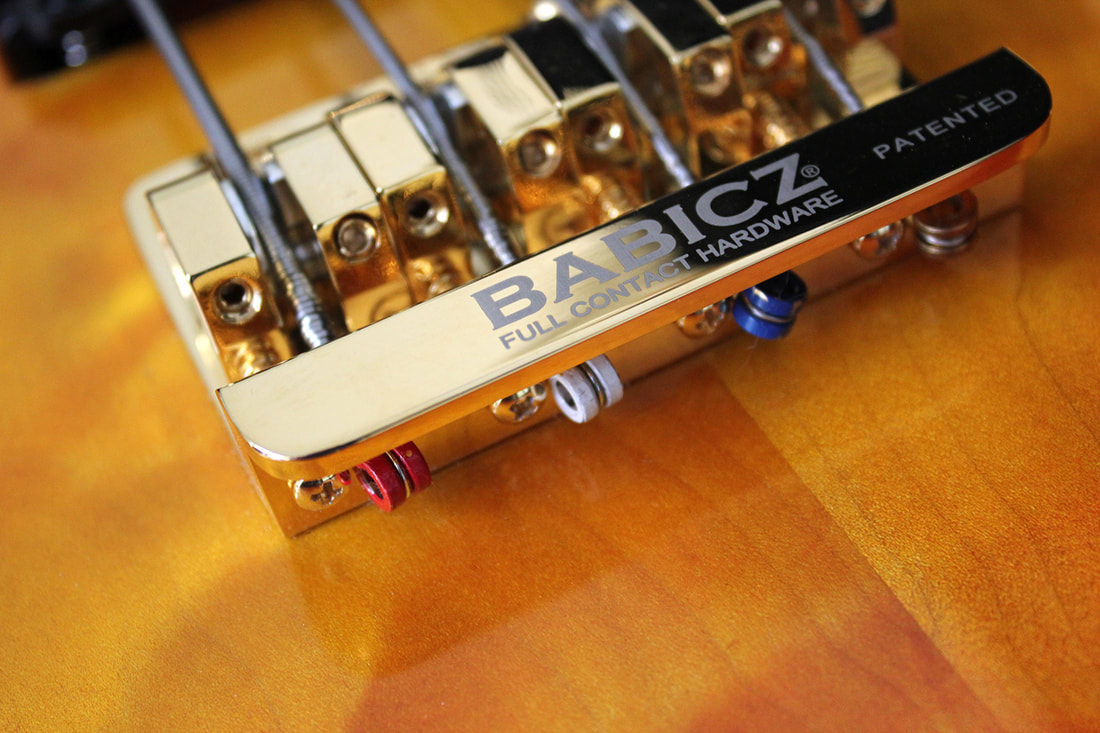

- Babicz FCH-4 bridge. Gold plated
- Spokewheel double action trussrod. Titanium
- Lace Alumitone Bass Bars 3.5
- Pure Tone output
- On-on Toggle switch

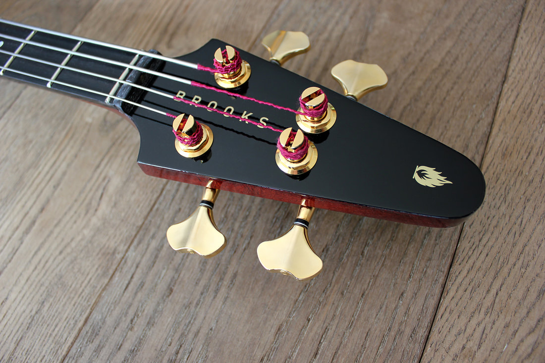

- Gotoh GB 350 lightweight bass tuners, Gold plated
- La Bella Flatwound Low Tension strings
- Weight: 3.2 kg (!)
