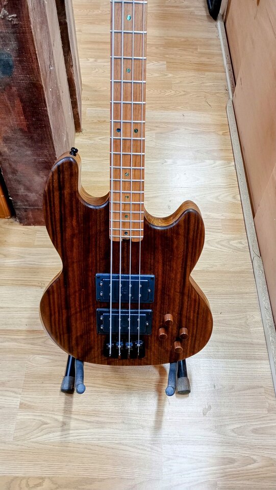

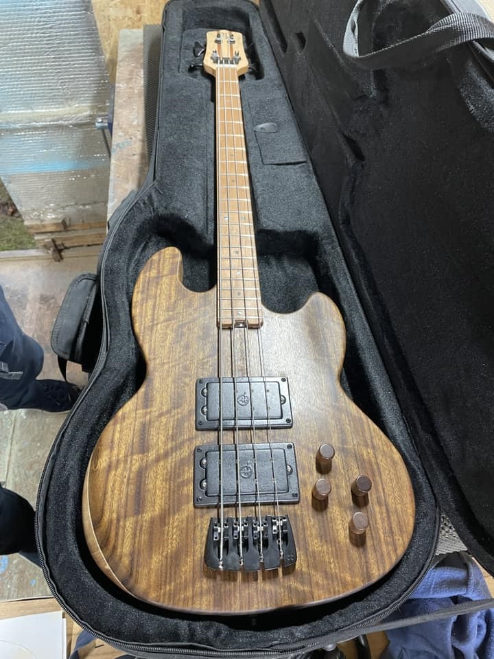

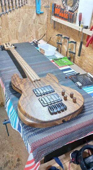

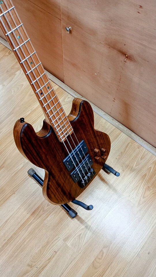

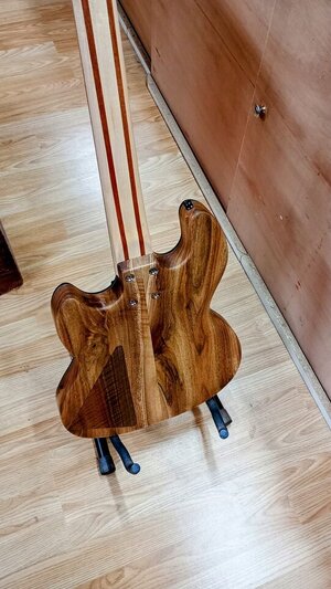

So there is an option to have a WAL Style Bass for about 2000€.
Oh there definitely is.
A good friend had this made last year, same builder did my walnut 51 P-bass.
Herrick multi coil, Lusithand preamp. Sadly I don't recall the drop top material.
Final cost was £1400.
