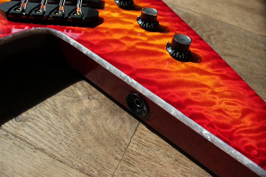

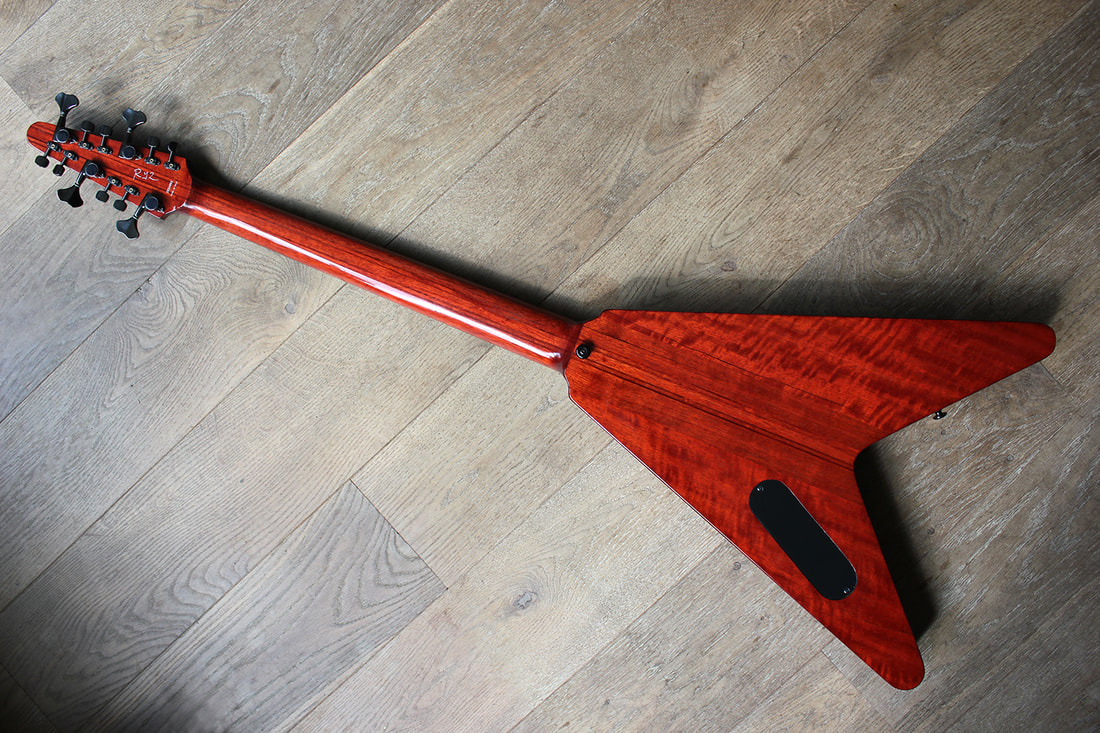

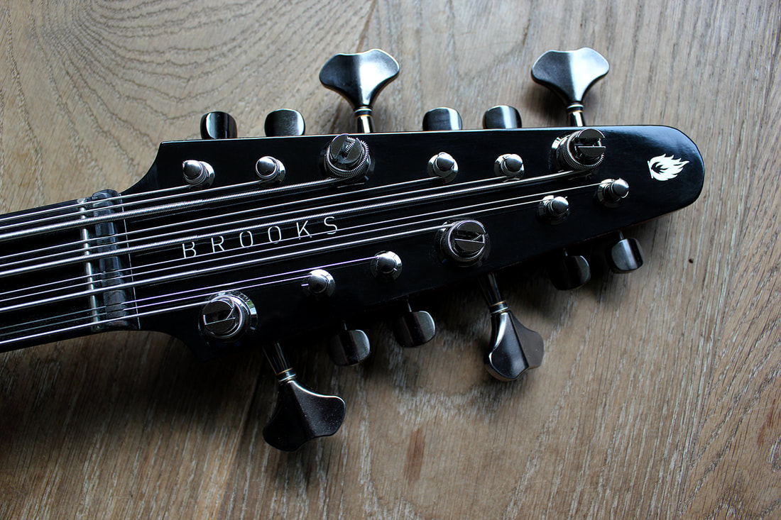

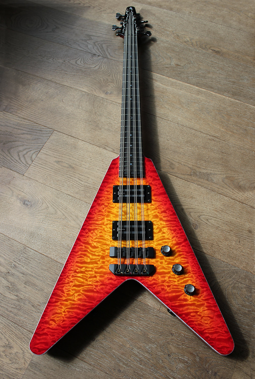

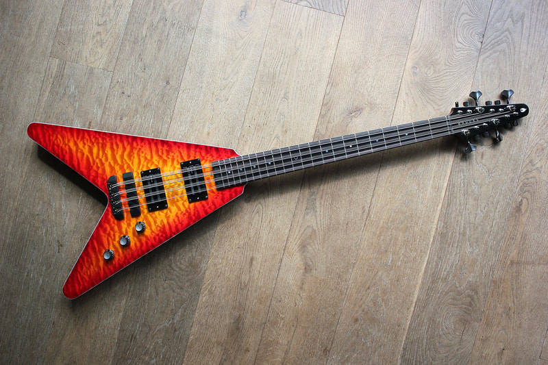

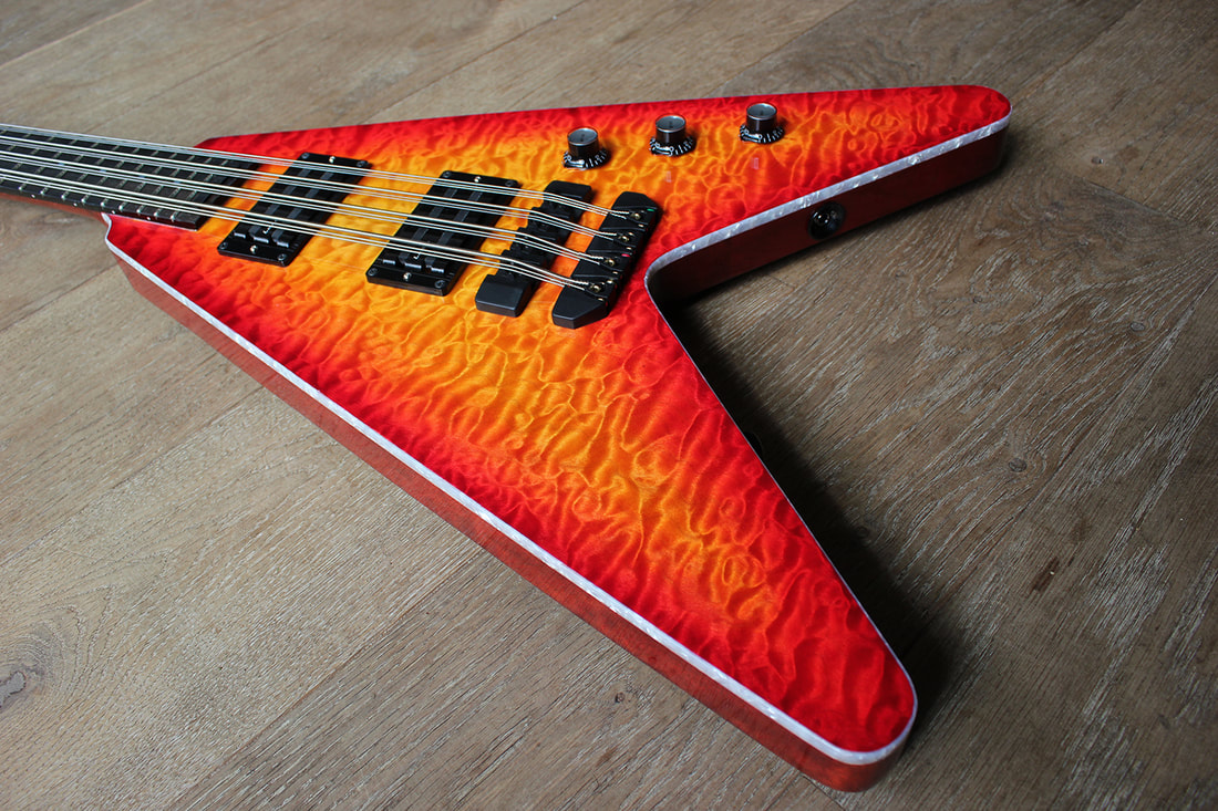

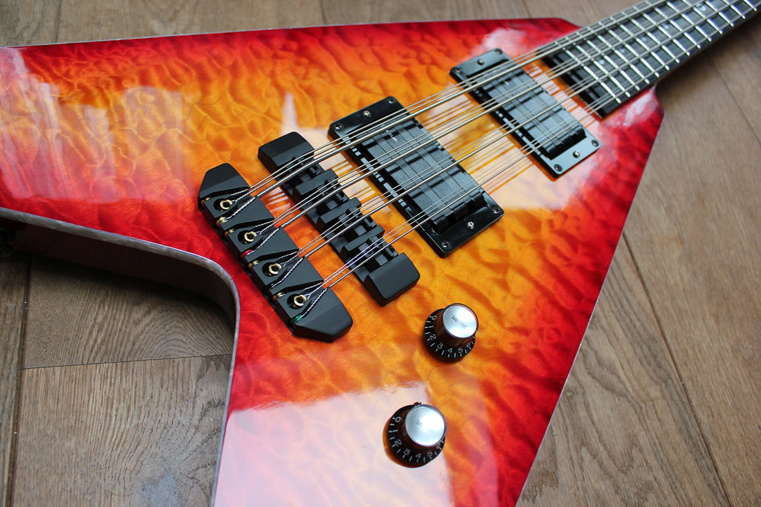

Hurra, ein weiterer Brooks-Bass ist geboren!
Brooks FV-12
- Korina body wings
- Bookmatched Quilted Maple top
- Nine ply Korina/Mahogany Neck through
- Cherry Burst high gloss finish
- Pearloid binding
- Ebony fretboard
- Mother of Pearl position. Aluminium Circle dot for 12th
- Jumbo frets
- 30 1/2" scale
- Buffalo horn nut
- ETS Custom made twelve string brass bridge and tailpiece. Black
- Two spokewheel double action trussrods
- Carbon reinforcement strip in the neck
- Pickups: Lace Alumitone DB7, Black
- Controls : volume, volume, tone
- 0.047mfd capacitor

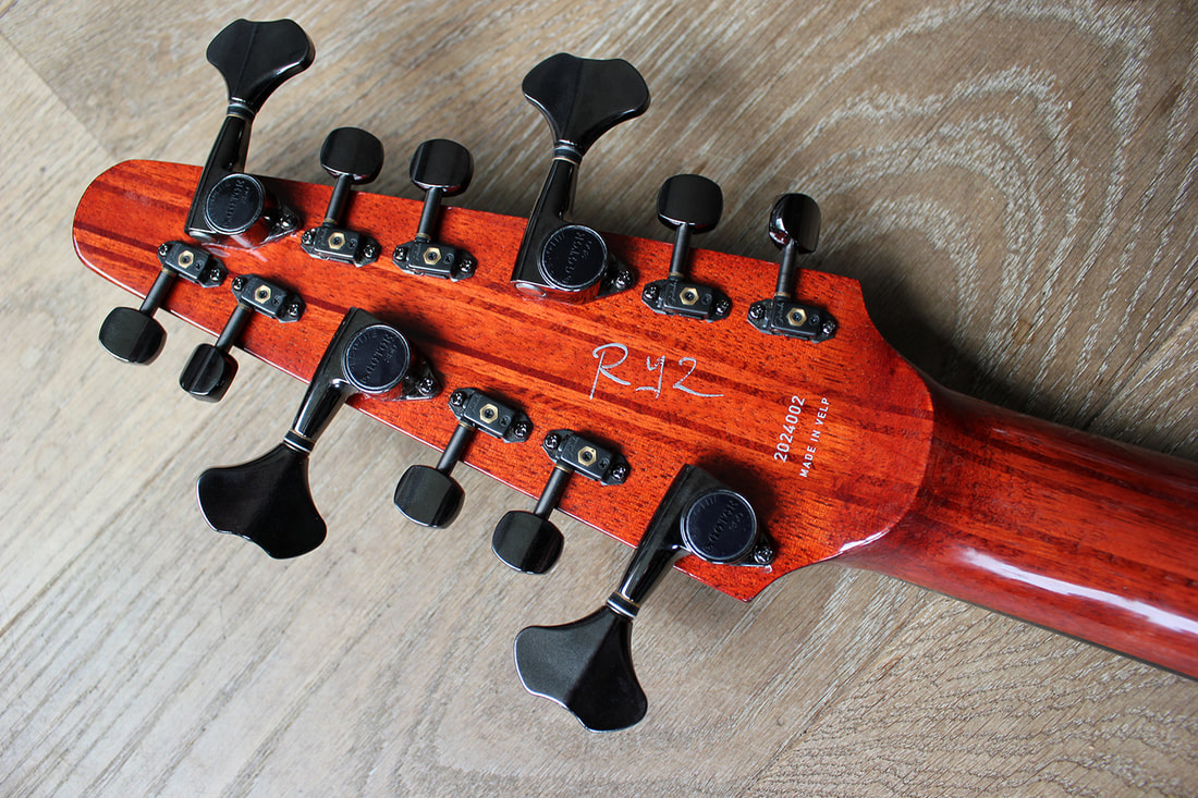

- Gotoh GB 350 lightweight bass tuners, Black
- Gotoh ST-31 octave string tuners, Black
- Output: Pure Tone Multi Contact jack
- d'Addario custom strings
- Weight: 4.3 kg
