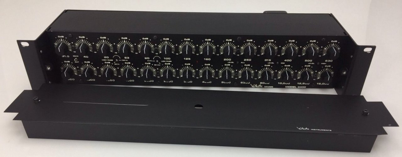

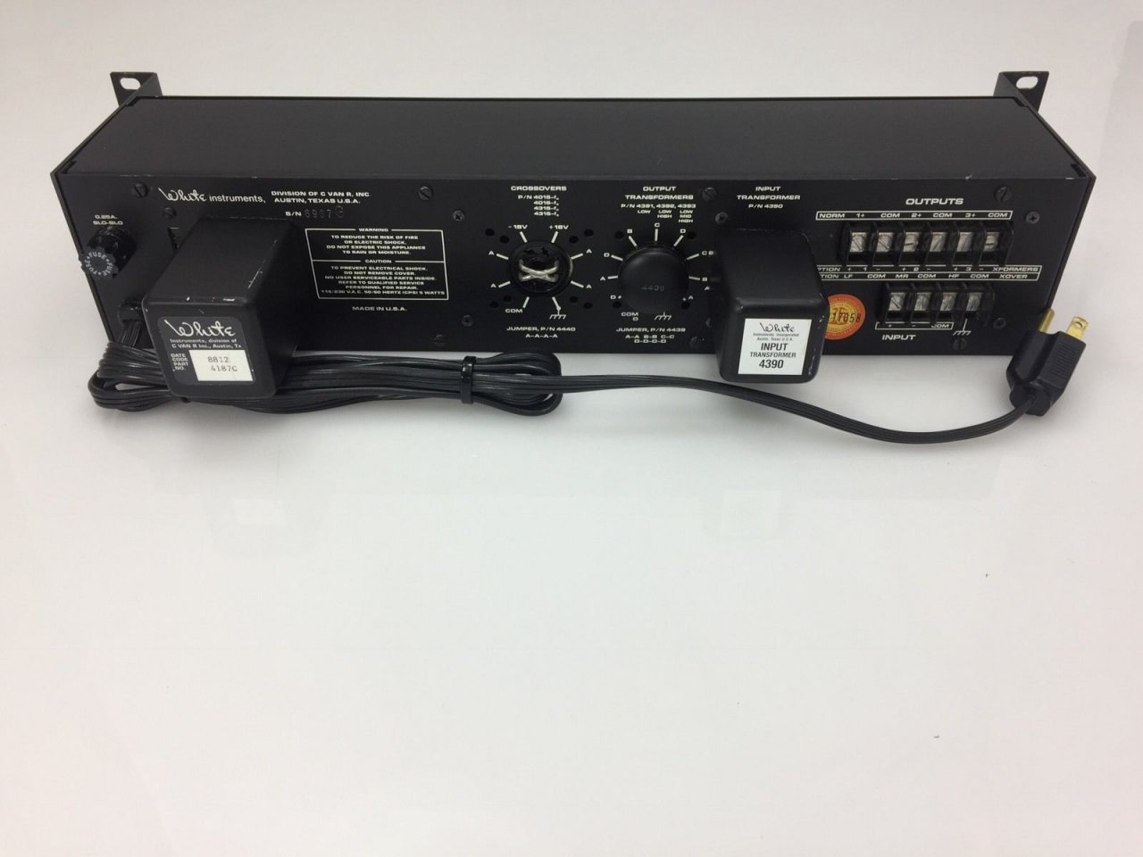

Mit einem neutralen Instrument/Linebooster davor > wäre der WHITE Instruments 4400 auch eine schicke Alternative.
Kriegt man leider zumeist nur in den USA.
Aktive L-C Filter > lecker :-)
Number of Channels:
One.
Frequency Range:
20Hz - 20kHz -2dB, typical with all 1/3 octave filters set at center.
Dynamic Range:
108dB
Recommended Operating Level:
0dBu (0.775 volts rms).
Maximum Operating Level:
+18dBu into 600 ohms. +15dBu into 600 ohms using optional output transformer(s).
Noise:
Better than -90dBu (re. 0.775 volts) at unity gain, 20kHz bandwidth. Worst Case.
Distortion:
Less than 0.02% THD at +18dBu into 600 ohms, 20kHz bandwidth.
Filter Type:
L-C active, single-pole pair.
Filter Control Centers:
28 one-third octave filters on I.S.O. standard frequency centers from 31.5Hz through 16kHz.
Filter Center Frequency Tolerance:
±5%.
Filter Controls:
Rotary potentiometers.
Filter Control Range:
±10dB at center frequency.
EQ In/Out Switch:
Front panel mounted. By-passes 1/3 octave filters only. Silent operation.
High-Pass Filter:
-3dB point adjustable from 20Hz -160Hz, 12dB/octave response.
Low-Pass Filter:
-3dB point adjustable from 20kHz -5kHz, 12dB/octave response.
Level Adjustments:
Input and Outputs 2 & 3; 0dB to -20dB. Continuously variable.
Connectors:
Barrier Strips.
Input/Output Circuits:
Input
Active balanced differential. Better than 70dB common mode rejection. Plug-in isolation transformer available.
Outputs
Single ended. Plug-in isolation transformer(s) available.
Input Impedance:
~100 kilohms.
Number of Outputs:
3.
Output Impedance:
<100 ohms. 300 ohms with optional output transformer(s)
Power Requirements:
115 /230 VAC, 50/50Hz, user selectable on rear panel, ~5.5W.
Dimensions and Weight:
3.5" by 19" (rack mount 2RU) by 8"
8.9cm by 48.3cm by 20.3cm
8 lbs. - 3.6kg
Finish:
Black painted brushed aluminum. White nomenclature. Matching metal security cover furnished.
Accessories:
Clear plastic security cover
Please specify when ordering.
Transformers
4390 Input Transformer Plug-in.
4391 Single Output Transformer Plug-in.
4392 Dual Output Transformer Plug-in.
4393 Triple Output Transformer Plug-in.
Crossover Networks
Please contact White Instruments.
6, 12, 18 & 24dB/Octave for Bi-amp & Tri-amp.

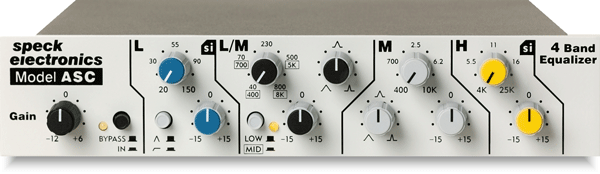

Gibt es eigentlich parametrische Equalizer bei denen man wie bei digitalpulten bei 4 Bändern jeweils die Form des eq (z.b. spitz oder Glocke) und dann noch frequenz und Dämpfungsfaktor einstellen kann? Ich finde so ist man extrem flexiebel, kann breit formen und störfrequenzen gezielt einzeln rausfiltern ohne breitbandig einzugreifen.
Gibt es sowas als einkanaler?
  • #77
Ich habe mir kürzlich nach langer Recherche diesen hier gekauft. Ein Studio Gerät, 1/2 19".
Das ist der mit Abstand beste EQ den ich je hatte.
Viel musikalischer als der TC und ähnlich flexibel.
Im Ausgang sitzt ein Jensen Trafo den man Wahlweise nutzen kann oder auch nicht. Der Trafo macht den Sound sehr homogen und rund. Die Transiente rückt näher an der Tonkörper aber ohne an Dynamik und Detail zu verlieren. Ein bisschen wie ein Kompressor aber eben ohne Kompression. Schwer zu beschreiben....
Der Headroom ist Top und das Ding klingt aller erste Sahne. Er verkraftet problemlos bis zu +28dB im Input.
Den Sound würde ich als neutral aber sehr kraftvoll und ausgesprochen musikalisch bezeichnen.
Vor allem kann ich endlich mit diesem EQ das (Tief) Bassverhalten meiner Bassanlage(n) perfekt anpassen. Endlich!
Die genaue Kontrolle der Bässe sind das A&O für mich auf der Bühne und ein Punkt der mich oft Live beschäftigt wenn ich "nur" den Amp EQ zur Verfügung habe.
Wenn man mit einem Gerät dieser Klasse arbeitet, merkt man schnell warum man dafür auch ordentlich Geld hinlegen muss.
Das ist eine ganz andere Liga. Alle EQ's die ich bis jetzt hatte wirken dagegen billig und im Sound nicht überzeugend.
Ausnahme: Der EQ des Bass Art Classic Preamp. Nicht ganz so flexibel in den Bässen wie der Speck aber im Sound sehr gut.
Ich habe ihn Huckepack auf meinen Steamhammer mit Klett befestigt und ihn im EFX Weg eigeschleift. Er dient mir so nur für meinen Bühnensound und geht nicht ins FOH.
Buuuummmmm,
Paul
Reaktionen: LovinRomance, lila_vila, ullebass und 2 andere

  • #80
@Paulito
"ran an den SPECK" > super Teil :great:
Ist ein hochwertiger "Auszug" aus einem kompletten Channel Strip (ihres 16 Channel Mixers) den die Jungs unterschiedlich vermarkten > kluge Idee.
Wird so über den Daumen 1K€ kosten > wer für seinen Job gutes Handwerkszeug benötigt sicherlich eine Top Lösung.
