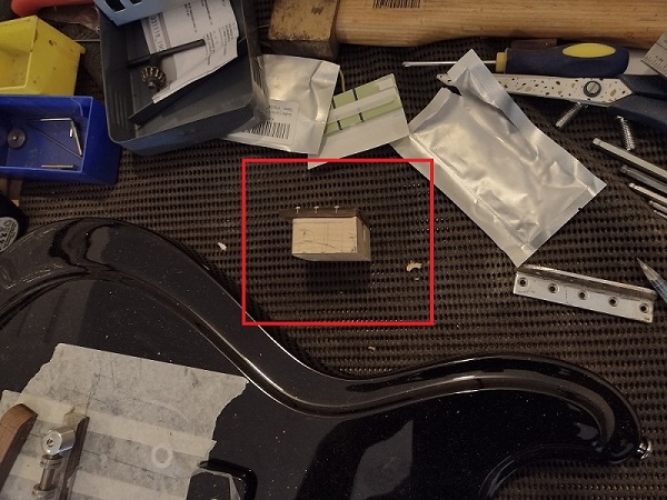

String tailpiece may be added to appear more 'authentic'🤣
This afternoon I took things slightly farther than a tail piece:D
Mosrite basses were 20 frets, later 22, but the baritone neck I was using had 24 frets. 24 frets no more🤣

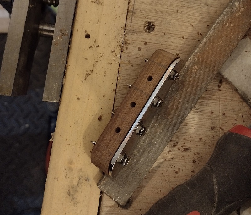

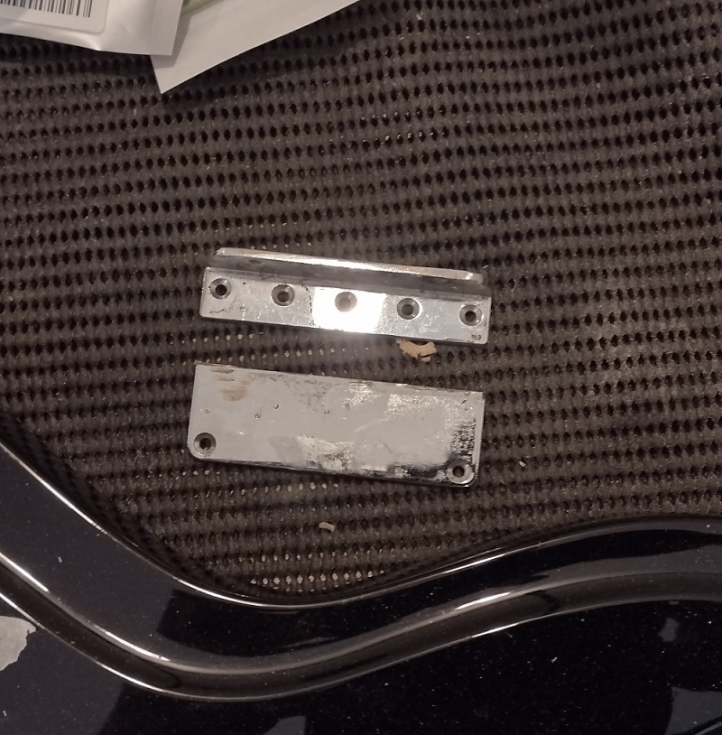

AI now had to re-position the bridge, this was a good time to replace it altogether. Guyker version of the 'Space Bridge' has a vibe akin to the original bridges, made a rosewood 'floating bridge' cradle for it. Floating bridges require string anchors or tail pieces, I knocked one of those up too.

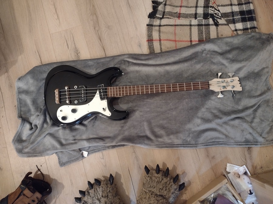

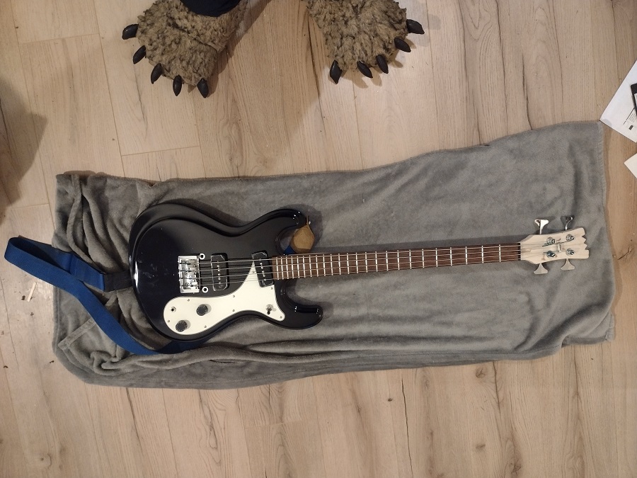

From this.
To this.
Was it worth while ?
Reaktionen: bassmansemi, Dommbasstisch, feierabendbass und eine weitere Person
