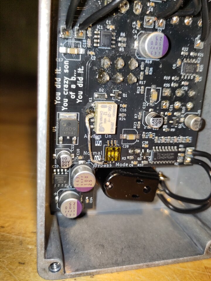

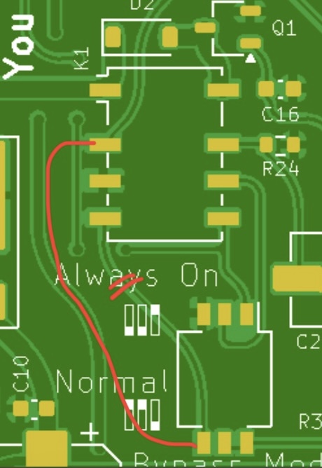

Also ich kann nicht löten 😳.
Wie gesagt, geht auf meine Kappe.
Also nochmal deutlich:
Always on Modus funktioniert wie er soll uneingeschrÀnkt.
Im normal Bypass Modus ist der extra Drive aktiv.
Wer das GerĂ€t eh nur always on nutzt oder sich daran nicht stört, weil Terre eh immer gut ist, kann es ja auch so weiter nutzen. Aber wer im normal Modus wirklich clean clean haben will, kann sich natĂŒrlich an mich wenden.
  • #162
AnhÀnge
Reaktionen: Ratterbass

I apologize for any inconveniences and disheartenment the news of the issue with the current batch of the Bass Jive may have caused. For full transparency, this is the exact issue:
In „always on“ bypass mode there is no issue!
In „normal“ bypass mode the drive section is always active, independent of the „mode“ switch position. This means in „normal“ mode it won’t be completely clean even with gain at 0.
The bypass signal is not affected and is clean as it should be.
Units that have not yet been shipped won’t be having this issue.
If you like the sound either way or use the pedal in always on mode (I designed the circuit so that you hopefully won’t want to turn it off anyways) you can just keep on enjoying the pedal. If you want to use the pedal in „normal“ mode and use it 100% clean, there is an easy fix, which we will be happy to apply for you if you don’t feel comfortable with applying it yourself (drill/cut a PCB trace, solder a single wire). In that case, please get in touch with us via info@jptrfx.com and we will sort it out. In any case, warranty will remain intact even if you apply the fix by yourself or through someone else.
