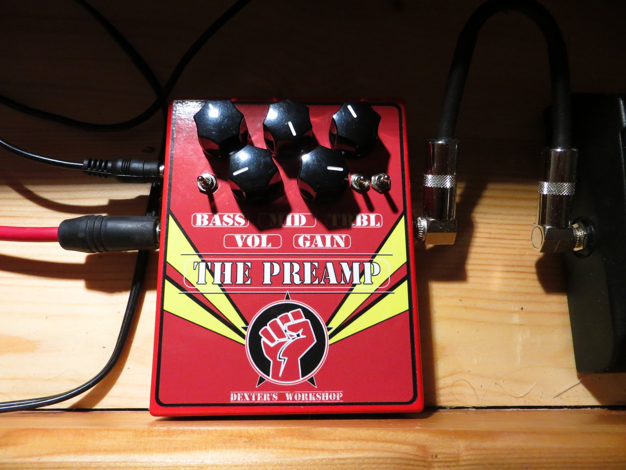

This is the last iteration on the MK-I /V2 preamp :)
I've also added the deepswitch inside as by request from @Willie, so along with the other features, a deep mode will also be avialable (so basically 6 mods are available via dip-switches inside... we have 4 more and we will have 10)

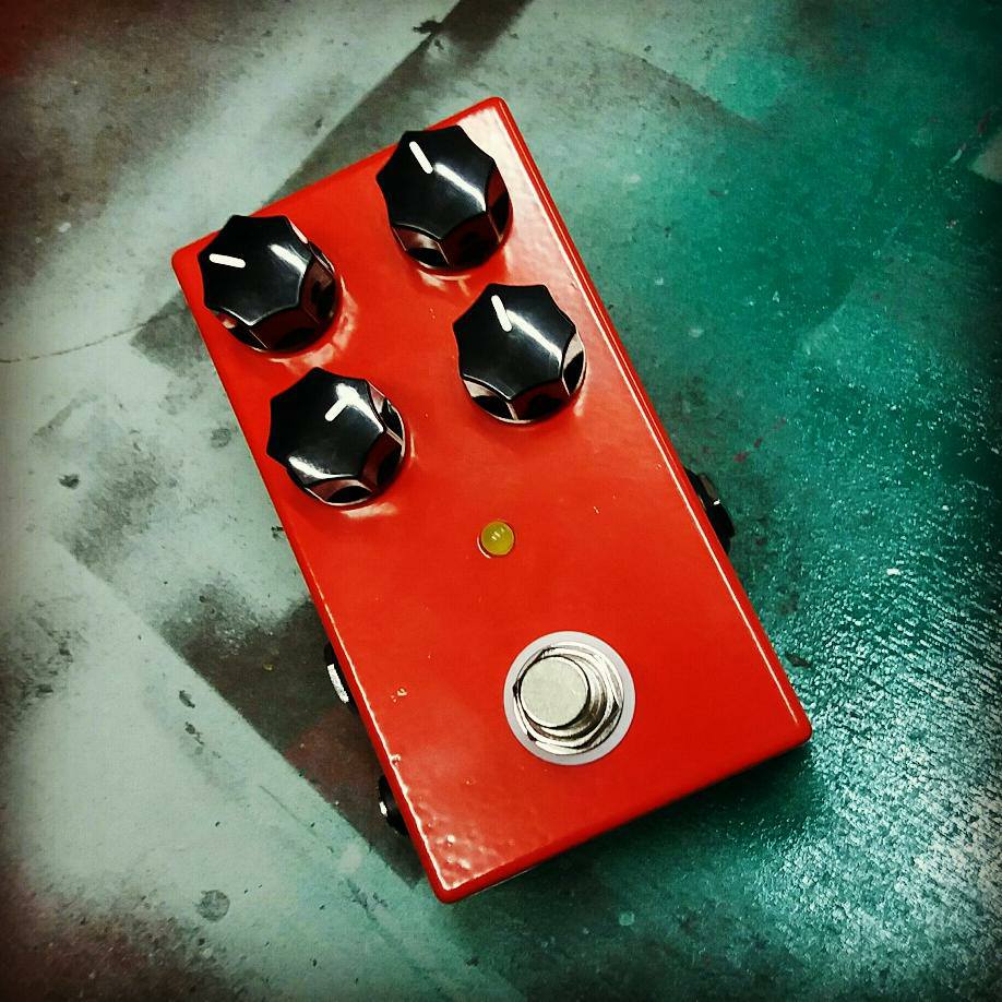

Until the PCBs will arrive from the manufacturer ...i had a little bit of time to finish the ParaBoost (parametric Booster)
It has a parametric EQ section with Cut/Boost, Freq. and Q and a clean boost section with aprox. 20db of boost (a little bit more than 20db). And the boost section is the one that @f_luxus (Felix) is using.

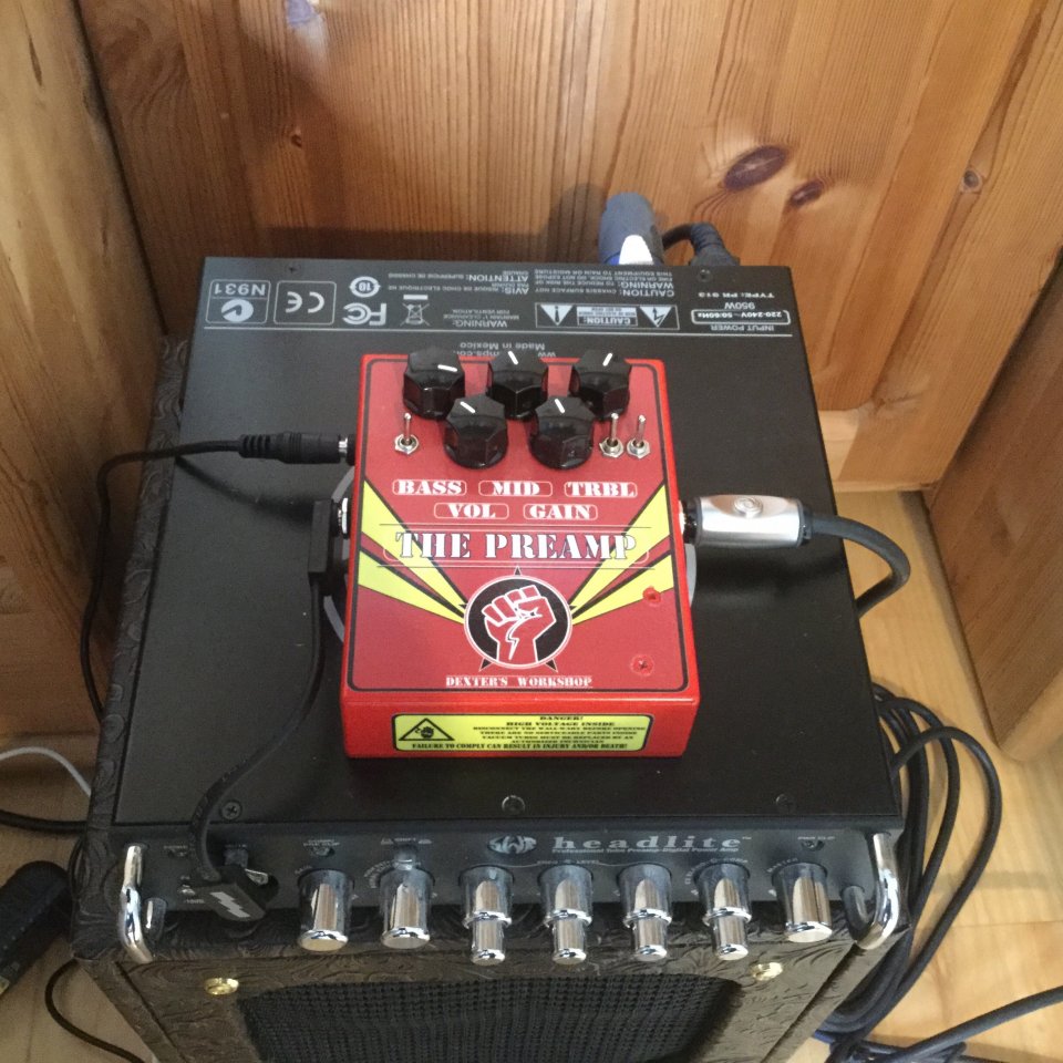

Just finished my modifications, and they sound great.
Now I got an deep switch, which brings more base to the sound.
Then I made the bright cap switchable. And the last switch just activate another cap for the treble pot. This will emulate the bass input of the typical Fender tube preamps.
So the next (and maybe the last) mod will be a true bypass...

Very very nice! For the treble cap did you put another cap in parallel with the existing one?
A bypass i dont think that there is enough room for that and would also imply some cuts on the PCB.
An external bypass box would be more usefull, i could draw you a diagram if you like.
  • #613
Yes, just another 220pF and a 1M, so it don't pop. Same for the deep switch. 47nF and 1M.
Thanks, but no, I made already many of this. Maybe I try my new micro relay looper on this.
PS.: just correct the cap value for the deep switch.
