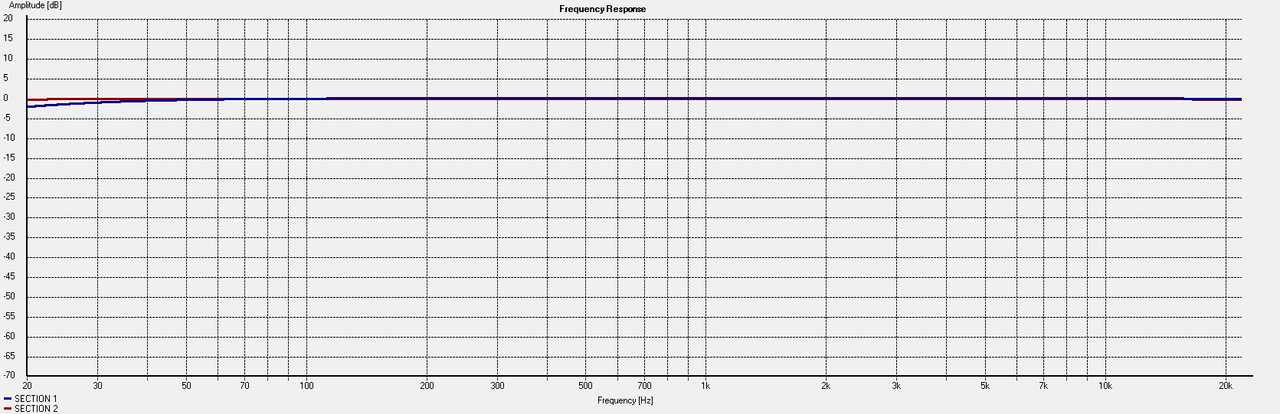

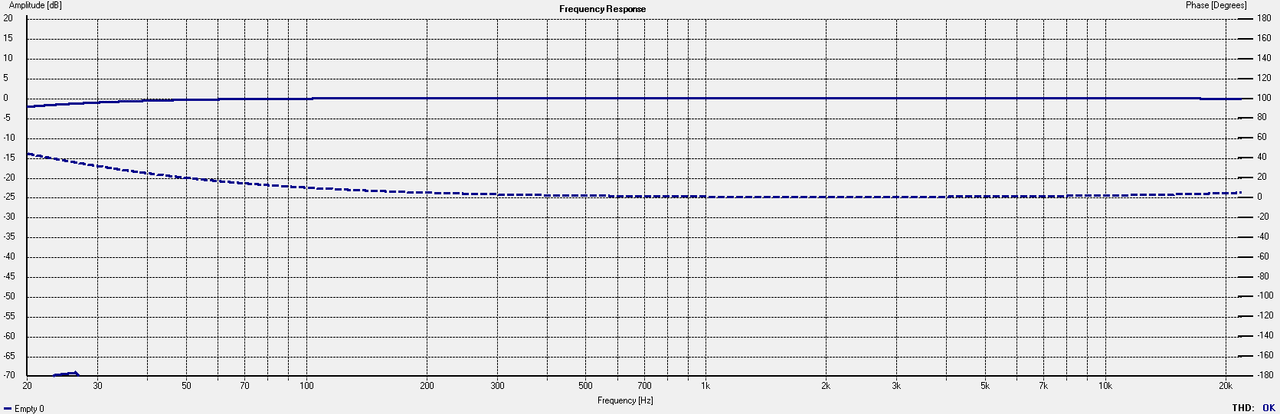

So the buffer is finally ready and we have liftoff :)
Made couple of measurements and turned out excellent
Here is the finished buffer

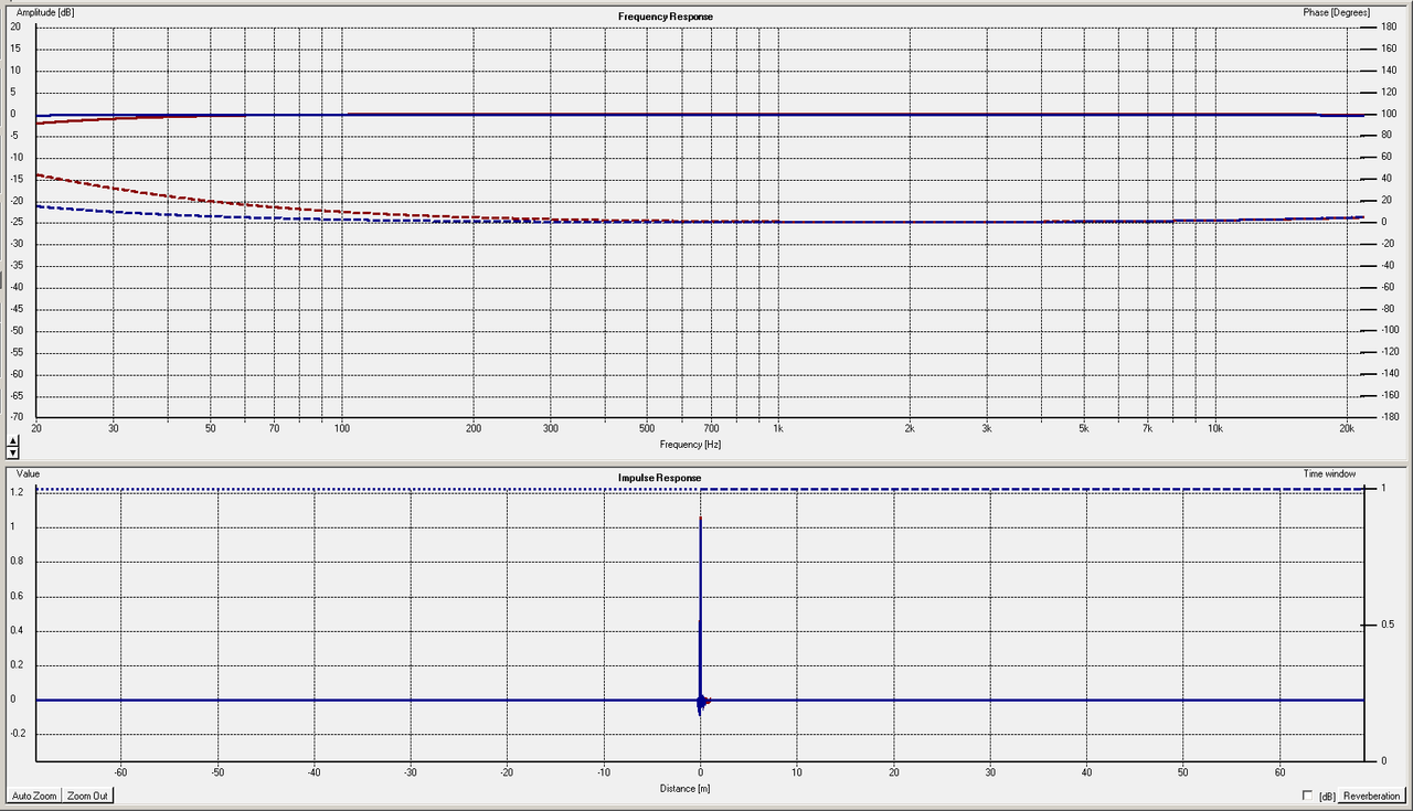

And here you can see the frequency response for each section, along with the phase plot.
The noise floor is around -100db without an enclosure
And it sounds amazing .. it adds some punch and some clarity there.
And phase plot under a heavy load.

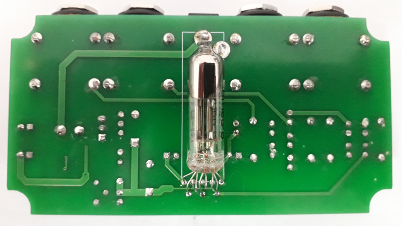

A small inside peek from the assembly process for your own entertainment :)
Reaktionen: Gast5650, aBaxxi, Gast74634 und 6 andere

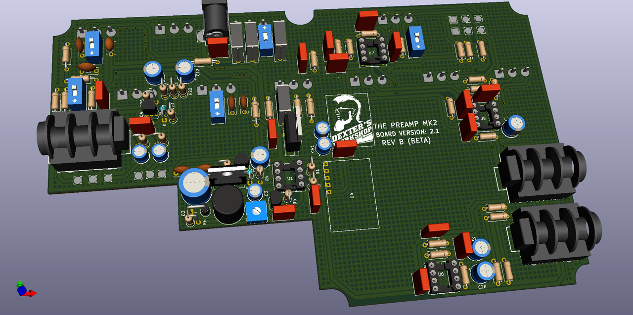

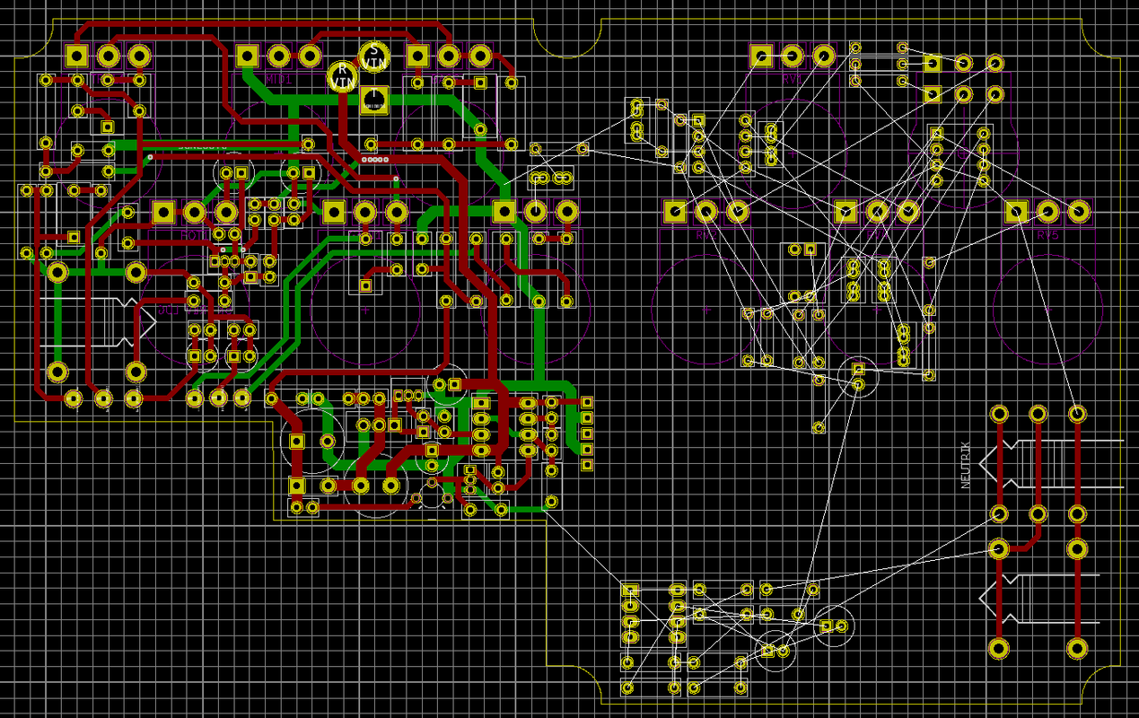

Ok guys ... it's on. The THE PREAMP MK2 release is sooner than i expected - i've modified the project a little bit but in the end i do think that it would be a very versatile tool
Description: full tube / high voltage bass preamp
Controls: Boost (up to 24db of boost) / Bass, Mid, Trbl (classic tonestack)
Internal controls: input pad -6db, bright switch, deep switch, high cut (high shift) switch
Filter (post tonestack): HPF, LPF, BPF with frequency and Q controls
Output: Unbalanced and balanced outputs (TS and TRS) with the option to have only the preamp output on the TS jack.
Reaktionen: French, Gast5650, goldbass und 10 andere

Looks great @DeXTeR :great:
What kind of enclosure will you take for the Preamp or better: do you already know the size of the pedal?
  • #955

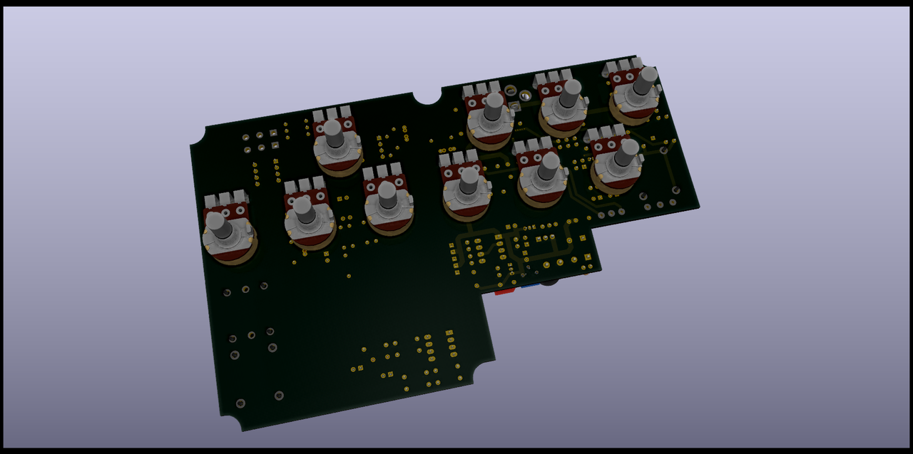

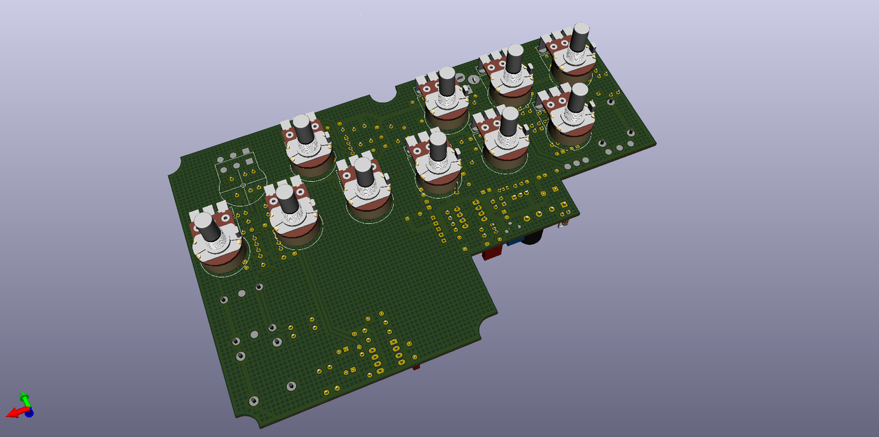

The enclosure will be 188x120x57mm - that is Hammond D type enclosure - it was almost impossible to put 9 potentiometers in a smaller enclosure.
I mean... that's an BB-Enclosure.... with DI-Out and Topmount-Jacks... :D
8f420c42-fb52-4b1d-a263-95852acc5796-jpeg.277103
SCNR! I fully understand... with the tube, step-up-converter etc. it gets really hard to layout it properly.
I guess the HPF/BPF/LPF is SVF-based?

  • #959
Not to mention that a 250V cap is 5 times bigger than a 35-50v cap.
Plus the necessary safety distance between traces and clerance.
And yes the filter is SVF

All right my dear friends. The boards for MK2 are sent for fab and should arrive in 14-15 days from now.
And then we will have the first prototype of the MK2 Bass preamp - and i'm very excited about it ... very very excited.
