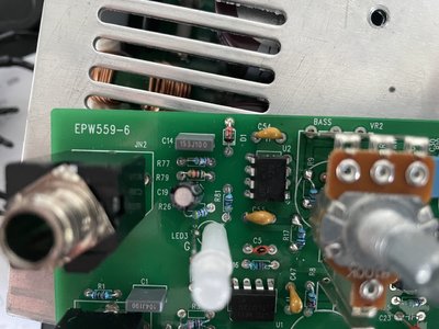

Hello everyone, Morten from Denmark here.
I’ve been following this thread for some time, and recently bought a B-stock Block800 with the intention of modding it as described by @Stratitis. The amp that was delivered was a MkII version, with the slightly different layout in the EQ section. I can see in the manual that the EQ points have been moved to 60, 200, 1K and 4K, which I guess explains the differences on the board.
A thing that I noticed is that I cannot get the clip light to flash no matter how hot an input I plug in. My ShiftLine Olympic at full tilt into the 800 with input gain at max, will not do the trick.
Looking inside, the resistor R79 has a value of 5k6 and has a beige background compared to all other resistors which are blue. Not sure what mkI had there.
Has anyone modded the mkII version yet? My plan is to only perform step 1 and 2 and leave the EQ and input as is, all the components included in the original mod, seems to be the same on the mkII.

  • #403
Hi Morten, the clip led is only enabled when the power amp is being to be overdriven. This happens at terrific high volumes. Clipping of the preamp stage will not affect the led if the master volume is not high enough.

  • #404
I see. Thank you for clearing that up for me.
I haven’t managed to overdrive the preamp in the unmodified state, only the headphone out.
  • #405
The headphone out is really crappy, it is very noisy and tends to clip even at low master volume settings. They use an own small headphone amplifier chip with a high internal gain. You can smoothen that by soldering a 22K Resistor in the blank position R109. If that's not enough, you can replace R100 and R101 by 100 Ohm instead of 4R7.
There shoud still be enough ouput, if you crank up the master volume a little more.
Reaktionen: Dennis_Kuefer
