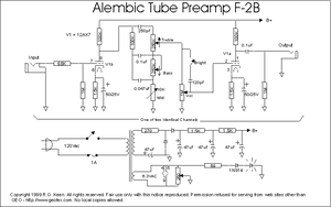

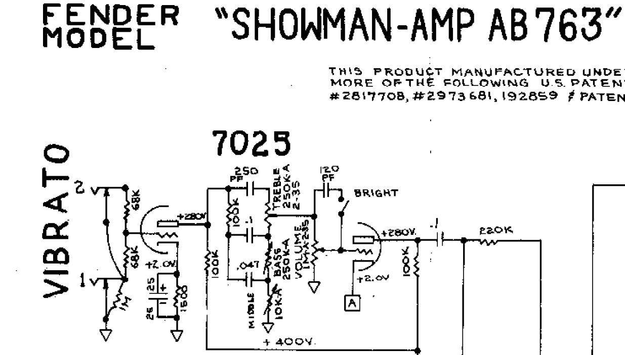

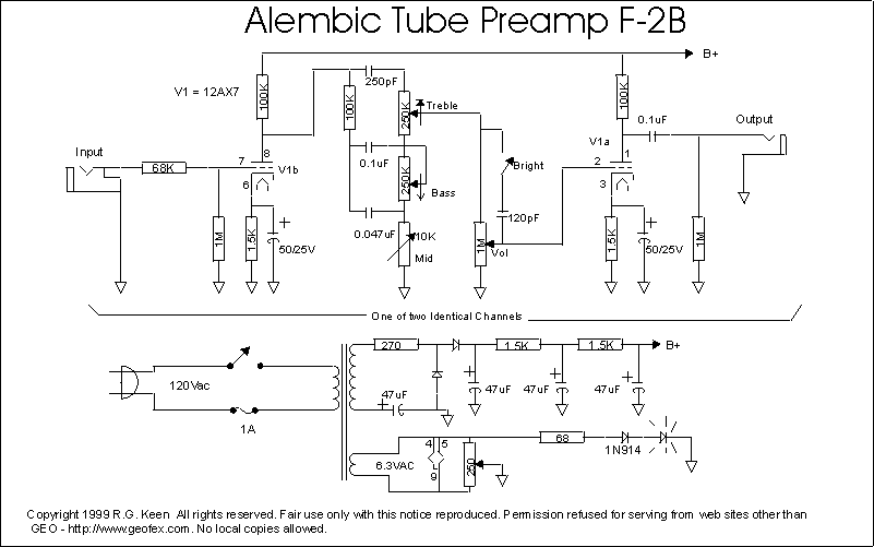

Fine, one thing only, i thing the Alembic FB2 is based on the dual showman and is using something like the Fender tonestack. I'm a little confused... :?:
  • #527
That is correct @Willie - F2B is based on Fender Showman and indeed the TS is based on Fender TS :) there is no secret about it :D even Alembic said that :D

  • #528
Because in the ToneStackCalculator, where you show the images from, you use the model of the marshal tonestack...

  • #535
@Willie - please modify the value for the MID pot to 250K (lin) and you will have the same response (there is a difference of less than 0.3db) :D (my mistake when i've choose the model) - basically is the same TS ... there is a difference on the behavior at the end of the travel for the MID pot.
There is no way i'm afraid to simulate the bright cap on this utility but there are other ways like PSpice or Labcenter Proteus.
So the simulation model is valid for both TS (Marshall and Fender) - because in the end are the same type of filters.
