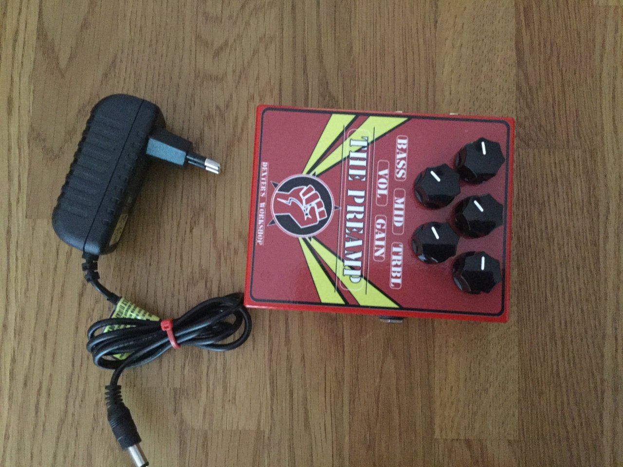

Meiner ist auch da :) Klingt sehr angenehm! Super verpackt! Danke an alle, ich kann leider keine Pokale mehr vergeben, sonst würde ich jetzt damit um mich werfen ;)

I use only the preamp into the return of an carvin amp with a 15"/8" fmc box and I'm happy at all with the sound. Very good job dexter, thank you very much! I'm excited about what the people here find out in special mod's and in the end you can please put it all in a 19" sice box with an DI out :)

Not direct comparsion until yet; now i played my active 5 string with the dexters and i can already say:
More flexabilty with the dexter's: a little less on the bass controller and i have a good sound!
Not so with the Bassmaster.
This is my first experience with a passive tone stack.
Reaktionen: lila_vila, f_luxus und DeXTeR

Yeah I like 'em a lot! Sounding really great and when you take 'em out of the signal chain very quickly to get almost an A/B comparisson s.th. is missing!!!
I use 'em very flat just to warm and brighten up the sound. It's working really good!
The only thing that I'm confused about is that my bass and treble potis don't do much, not to say nothing. Like I said it's sounding great and I make my main EQing with a Subway DI after the Dex anyway but I'm wondering whether the bass and treble potis are working VERY subtle, or are they broken:-/.
I will try to measure it tomorrow evening by sending a pink noise through it into a DAW while trimming the potis.
Sry for the bad English and thanks a lot for this great product!

@Spichler the controls for treble and bass do work very subtle indeed and are highly dependable on the instrument taht is plugged in.
Harald made a mod on his with a bypassable bright cap - he posted that mod up on this topic.
It can be done by anyone.
Adding a bright cap on the gain pot added more definition on the high end but the range of bass and treble was modified and the modification of bass and treble is only 1db at this point for the bass freq. range.
I hope ive made sense
