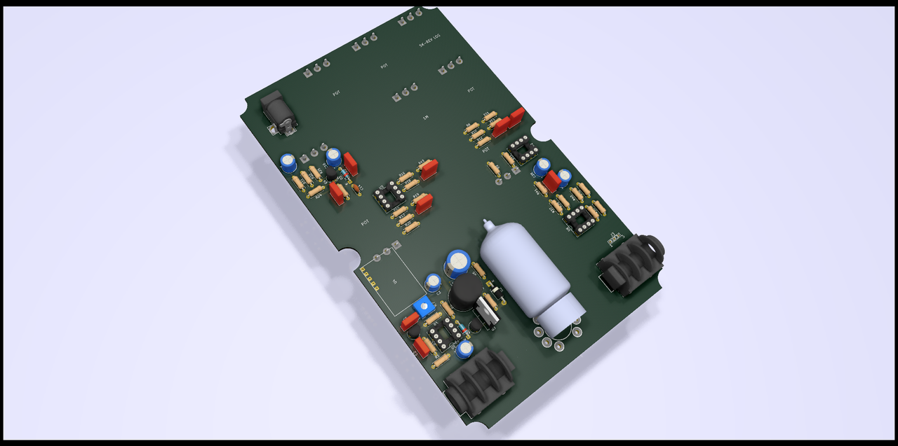

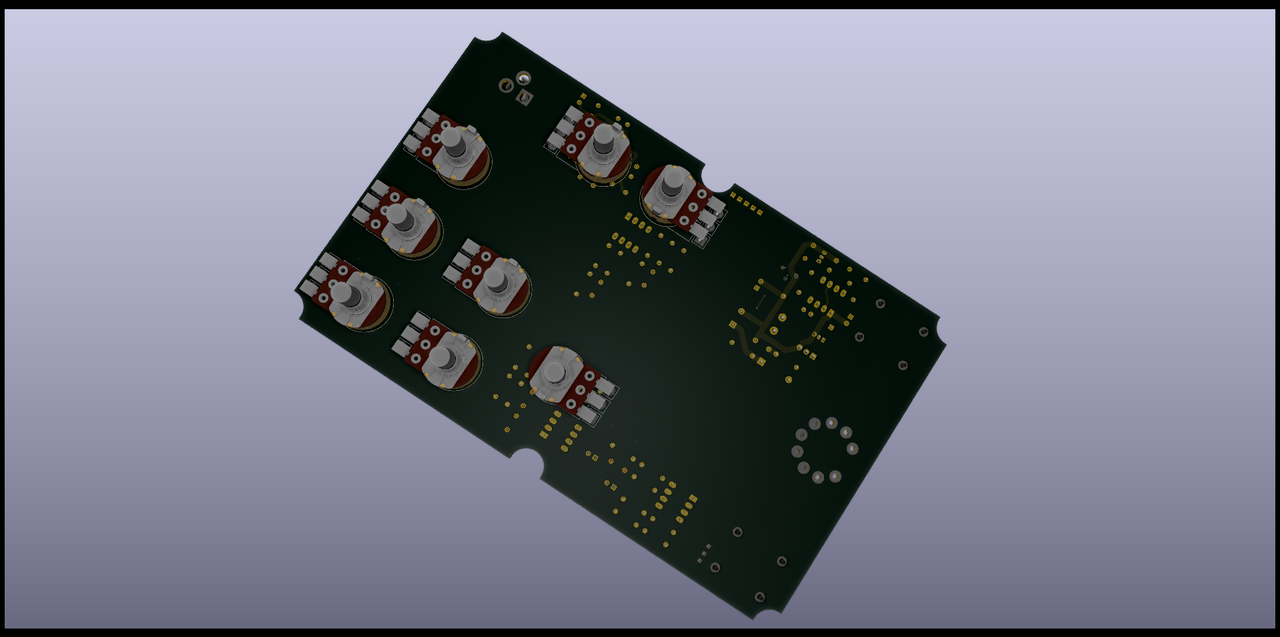

Ok time for a small sneak and peek
The features for the new preamp will be as follows:
- a boost stage made with my linear booster flat from 10Hz to 22KHz that would allow you to overdrive the tube if you like in a much harder manner
- HPF
- LPF
- 1 or 2 band parametric EQ (i will have to see how is the real-estate)
- balanced output
- unbalanced output
And of course all the features from the preamp V1 MK2 (pads, deep switch, bright switch etc)
And this is how is going to look :)

The switches will be outside yes :) hopefully all it will be accessible from outside :)
If not ... i will get a bigger enclosure :))
Would it be possible to have these switches accessible from the outside?
Reaktionen: OliB., goldbass und danielthieme

  • #809
One more question: will the DI be transformer-based?
No, it will not be transformer based, it will have a dedicated driver

Thank you and a picture would be awesome!
Yes, i will try to stick a 2 band para in it (in the end i could use another enclosure anyway :) )
The bypass will not be available, because as i said in a previous post... you will have a balanced output ... now having an instrument input with a balanced output would be useless and all in all is a preamp which is supposed to be always ... on, is not an effect.
