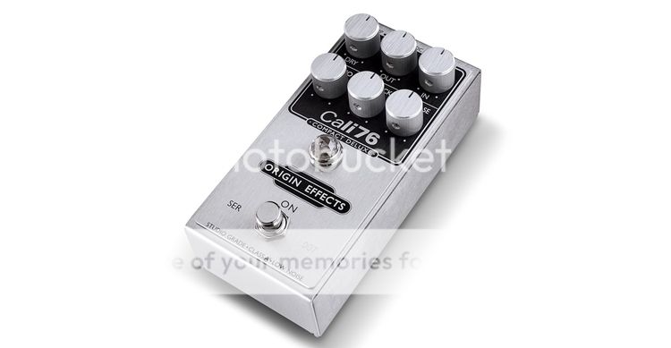

Hui :O! ...dieser könnte auch ein interessanter Kompressor werden...
The Cali76 Compact Bass is an 1176-style studio-grade FET compressor, complete with dedicated controls for parallel compression and sidechain filtering. We’ve taken everything that was great about the original Cali76, added new features optimised for bass and compressed the whole lot down into a pedalboard-friendly package!
A single combined Attack/Release control provides a continuous sweep of useful settings while avoiding combinations that can result in ugly distortion artefacts creeping into the lower registers. Meanwhile, the elegant jewel lamp functions as a three-colour gain reduction meter, providing vital and intuitive feedback to the player.
In addition to this pedal’s low-noise circuitry and fast, musical FET response, two special features lift the Cali76 Compact Bass above the competition.
The first is the Dry Blend control, which lets you mix your dry signal back in with your compressed signal for true parallel compression, an indispensable studio recording technique. By combining the compressed and dry signals, you get all of the tone thickening and increased sensitivity of the Cali76’s 1176-style compression, while retaining the natural attack and dynamic expression in your playing. It’s the ultimate in transparent compression – both fat and punchy at the same time.
This pedal’s second secret weapon is also culled from the studio engineer’s handbook. The Cali76 Compact Bass allows you to rein in the amount of compression applied to the lowest frequencies via a variable-frequency high-pass filter placed in the compressor's sidechain. With the HPF control dialled in, the compression ratio effectively becomes frequency dependant. The low strings come back to life, adopting an extra weightiness, power and dynamic response, while the higher strings are strictly controlled, preventing slapped and popped notes from leaping out of the mix. This unique bass compressor is like having your own studio engineer sat on your pedalboard!
The Cali76 Compact Bass delivers natural, musical compression exactly where you want it, letting the lower strings breath for more accurate dynamic transfer and greater perceived girth.
SMALLER SIZE WITH NO COMPROMISE
The original Cali76 is a big, beautiful compressor pedal that delivers studio-quality 1176-style compression using discrete Class-A circuitry that's true to the topology and design philosophy of the original.
The Cali76 Compact Bass is cut from the same cloth, sharing the features, performance and pedigree of its larger sibling, but with added parallel compression and a sidechain filter optimised for bass, all in a stompbox a third of the size of the Cali76 Standard.
Like all of our Compact Series pedals, the Cali76 Compact Deluxe features high-current, discrete, Class-A circuitry for transparent, low-noise performance. We've taken a no-compromise approach to the circuit design using only the best of modern components.
Rugged MELF resistors offer low noise performance and rock-solid reliability. Film and tantalum capacitors offer tight tolerances and superb linearity. Carefully chosen transistors biased at relatively high currents yield a distinct signal-to-noise advantage.
Please note: the Cali76 Compact Bass is powered by a mains adaptor only. We've dispensed with the usual 9V battery option, both to save space and to allow us to adopt a high-current approach, yielding lower noise levels and superior tone.

Gerade gelesen, dass es wohl noch weitere Mini Calis neben der Bass-Version geben wird. U.a. auch eine kleine Slide RIG Version. Hier mal ein Bild zum Größenvergleich. Auf der Webseite ist noch nix zu sehen.
Kombinierte Attack/Release Kontrolle macht mich etwas skeptisch....die Größe auch ( kleiner, aber keine Kompromisse?...hmm) Dafür finde ich die Sidechain Filter Kontrolle sehr interessant. Vielleicht wirkt die ja effektiver als das was ich am Empress gehört habe. Na...bleibt spannend.;-)

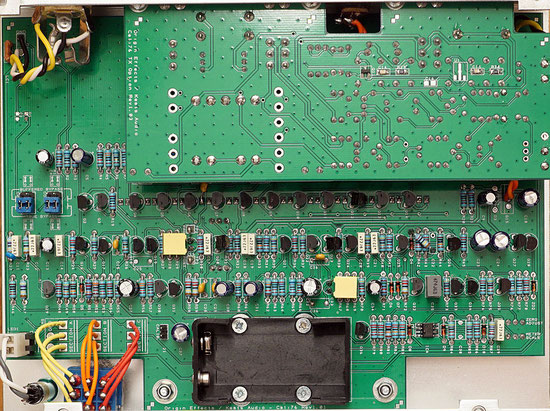

Mal schauen, wie sie das Innere eines Cali76 auf diese "Größe" zusammenschrumpfen...
Schade ist auch, dass es beim Mini-Cali keine LED-Chain mehr gibt...
  • #53
Man vermutet SMD bei gleicher Schaltung. Von sowas habe ich aber keine Ahnung. Am Ende entscheiden die Ohren.
Ach...wenn er einmal eingestellt ist, dann könnte es von mir aus auch von grün nach gelb zu rot blinken. Aber mit LED-Chain ist schon schöner, stimmt. Vielleicht auch ein Platz-Problem?

Ich glaube auch, dass "nur" SMD bei gleicher Schaltung möglich ist. Interessant ist das Teil schon, denn der Cali76 gehört m.E. mit zu den besseren Kompressoren. Und die "Größe" des Cali76 stört schon gewaltig, wenn man sein Board eigentlich klein halten möchte...
