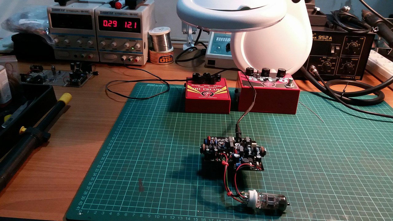

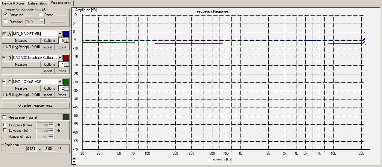

First i would like to say that ... i'm quite pleased how the MK1-V2 preamp turned out.
The most important thing is the fact that i've managed to tweak the SMPS so much that the preamp itself is pulling 300mA@12V (150mA being only the heaters ...so that would leave 150mA for the SMPS to go from 12V-DC to 250V-DC)...not bad at all i could say.
Second but not less important ... noise floor (which was already very very low) ..is even lower at this point - please keep in mind that the preamp was not in the enclosure when the measurements were taken ...
So...should I say more?
Basically right now the preamp can be run on any type of regulated power supply that can put out 12V@500mA DC - making it even more pedal-board friendly (it will be still deviered with the wall-wart but, if you have that specific voltage at that minimum current on your PB the use of wall-wart will not be mandatory).
Comments and constructive criticism is more than welcome as always ... oh... and the freq. response ... is quite ... flat as you may see.
FREQ. RESPONSE
NOISE FLOOR (THE PREAMP) is not inside the enclosure (so the noise floor will be even lower!)
Pulling only 12V @ 300mA
Reaktionen: f_luxus, anbra, stephan und 4 andere

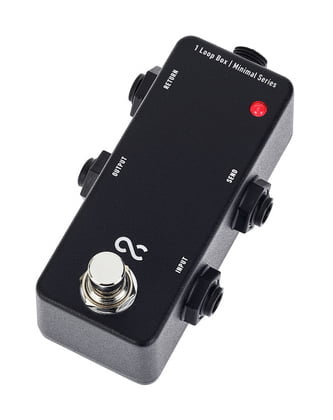

Hmm mal eine Frage:
Mit solch einem Fusschalter wäre der Preamp praktisch fusschaltbar machbar. Oder?
Hätte das einflüsse auf die röhre?
Reaktionen: RAVEN, f_luxus und bassdscho
  • #678
Ja, geht prima. Nehm ich auch.
Ist damit schaltbar und im Sound höre ich keine Veränderung gegenüber Normalbetrieb.
Reaktionen: RAVEN
  • #679
Didn't translate the posts, but i guess that you would like to know if you can use that particular bypass box with the preamp.
The answer is yes without any problems.
Reaktionen: RAVEN und bassdscho
