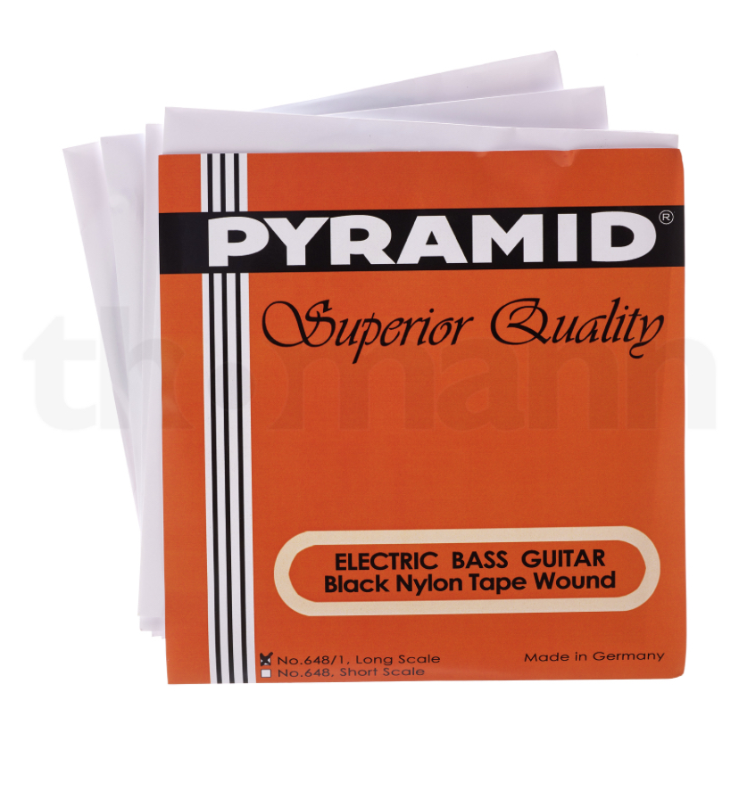

  • #80
pyramid nylon
labella deeptalking
labella goldflats
labella blacknylon
rotosound 77flats
Thomastik jazzflats
