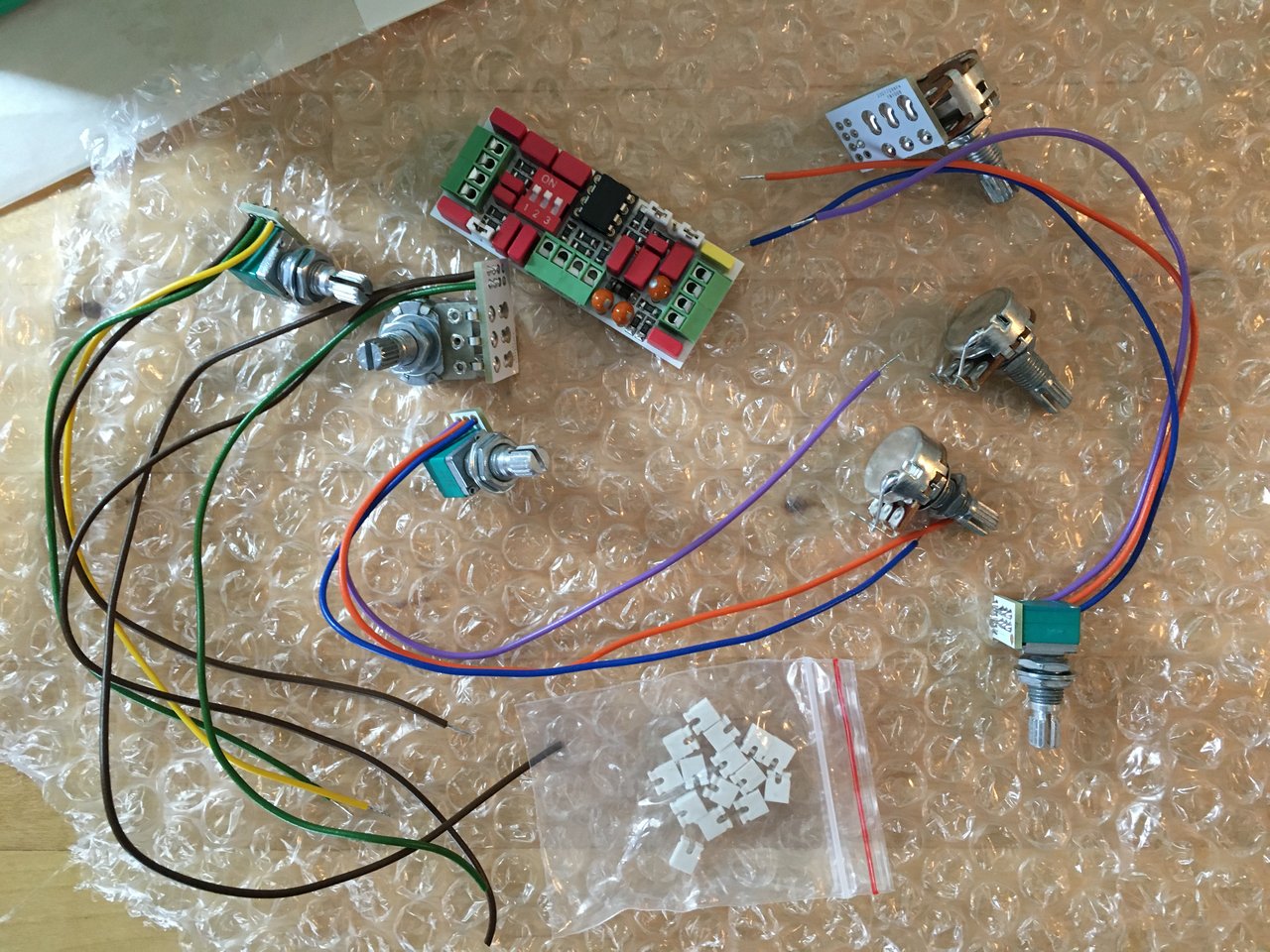

New Preamp day. Ein russischer Baz- Preamp inspiriert durch Fodera- und Spector-HAZ-Pres. Er hat mehrer Modi die man per Jumper verstellen kann. Dieses ist das 2-Band-Modell, gibt es auch als 3-Band-Version. Ziemlich kompakt, aufm Foto kam er mir größer vor.
Ich denke ich werde den zuerst im Webster verbauen, weil -das muss ich sagen - ich die BQC generell etwas lahm finde.
Ich poste dann mal vorher/nachher Samples.

Sooo, ein vorher hab ich zwar aufgenommen, aber da ging was schief (muss ich nochmal schauen)
Hier daher ein Demo mit dem Baz-Pre in meinem Webster Euro
Text aus der YouTube-Beschreibung:

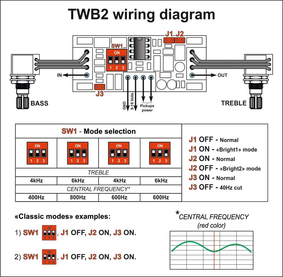

Installed a TWB2 2-Band Preamp by BAZcustom bass onboard preamps in my Spector Euro Alex Webster Signature loaded with EMG DCs and DR Hi-Beams. Straight into audio interface, no plugins.
This a preamp inspired by Spector/Fodera HAZ preamps with 4 different modes (frequency settings). It has also the possibility to set two extra bright modes as well as a lo-cut at 40 Hz.
This video showcases the four modes you can set (treble and center mid-frequency):
- 4 kHz and 400 Hz
- 6 kHz and 800 Hz
- 4 kHz and 600 Hz
- 6 kHz and 600 Hz
The jumpers are set to J1=Off, J2=on and J3= on which is considered as "classic mode". Treble and bass pots are fully boosted. When I played modes 3 and 4 for some clipping occured which was either my interface's gain set too high or the pickups. Sorry for that but you'll get the idea anyway.
The original electronics were EMG‘s BQC system. Everything except the pickups were removed.
Pots are now 25k blend and volume pot and a treble and bass pot. Everything‘s running with 18 V
The preamp is very quiet and definitely a great one. Reason I throw out the BQC was in that particular bass it rather showed no mojo and was bland and also I hate fiddling around with the mid-control (definitely not my thing).
There's also the possibility to set the pre to bright mode which adds some more glassy tones without being to harsh. Works fine with the EMG DCs. Don't know how it reacts with others or passives.
Die SW-Settings sind diese hier:
