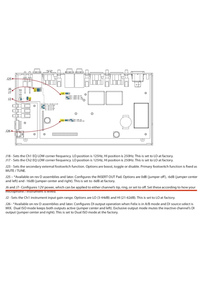

  • #22
Habe ich noch nicht gemacht, aber zu deiner zweiten Frage.... das kannst du dir aussuchen... aus dem Manual des Felix:

Ich zitiere noch mal aus dem Manual des Felix:
12V Power
Both Ch1 and Ch2 instrument inputs can be used to amplify
an electret capacitor microphone. These are common for applications where small microphones are mounted inside acoustic instruments, or lavalier style microphones used somewhere on the outside of the instrument. Normally these microphones will contain very small integrated preamps which require a small voltage to power. So the Felix can send 12V phantom power out on both of these inputs. This is activated via DIP switch # 5 on the side panel.
12V power can be applied to the tip, ring or neither of each channel’s input jack. Configuration is done via internal jumpers, described in detail on pages 12 & 13.
NOTE: this power supply charges up slowly, so you may need to wait a few seconds before signal from your electret mic is present at the input of Felix. And, as with 48V phantom power in the XLR mic input, it is always best to make your input connections before applying power at the DIP switch, and power OFF the 12V at the DIP switch before disconnecting your source."
Schon als "Phantom-Power" gedacht..;)
Und wo die Spannung an der Klinke anliegt, kannst du ja am Felix einstellen. Du kannst ja auch so ein Kabel selbst löten, dann bist du sicher, welcher Kontakt auf Pin 2 führt...;)
