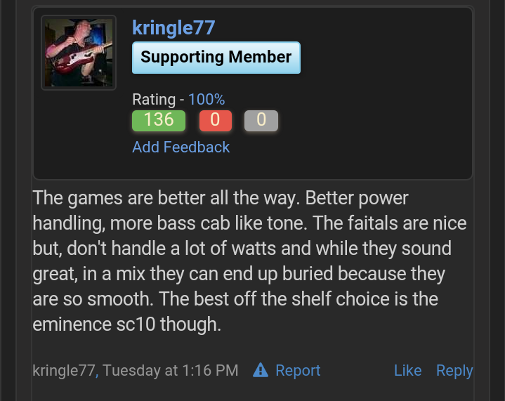

Hier ein Zitat von "kringle" aus dem talkbass der fanes und Faital verglichen hat (das "games" soll "fanes" heißen)

An anderer Stelle schreibt er: "...The Fane is a good middle ground as it has a good low end and clarity. It also sounds like it would hold together good at higher volumes like the B810. The faital is actually the best sounding of the group and is probably what I would use at home for a 1x10 practise cab but, even though it has good low end, it is alittle smooth when you pair a few of them together. I find that the Alpha 10 is probably the one I would use it I could only have a cab loaded with one type of driver. It has enough low end, probably just fine in multiples, good mids and just enough highs."
