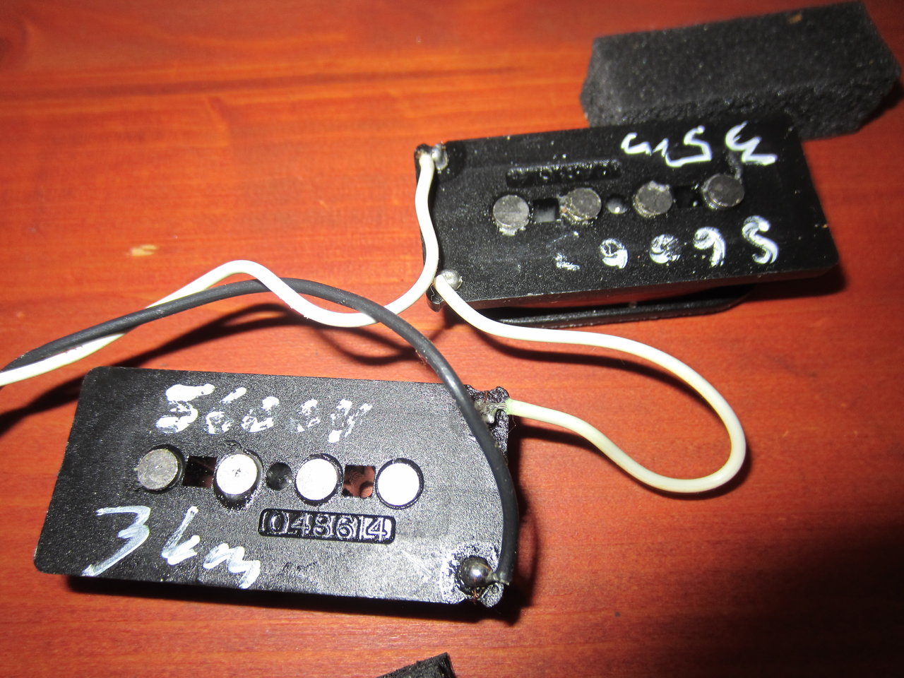

Anhang anzeigen 376561Anhang anzeigen 376562
Der PU mit der eingestanzten/eingeprägten "048614" ist zumindest auch in den Classic 50s verbaut...
Wird dort allerdings nur als "Vintage Splitcoil" bezeichnet ;-)
PS: Der gleiche PU werkelt(e) auch in der ab 2001 eingeführten "American Series" mit dem S1 Switch

Die Info kam von einem MItarbeiter von Fender auf Talkbass in einem Thread aus 2005:
Hello,
The number on the bottom is actually the part number for the pickup bobbin. These specific bobbins are indeed the ones that are used for the American Series (standard) P-Bass pickups. Below are some specs for you.
Best regards,
John-
Fender Musical Instruments
Specs:
Pickup: American Standard Precision
Position: Rhythm (Toward Neck)
Used On Models: American Standard Precision Bass
American Deluxe Precision Bass
California P-Bass Special
American Standard Precision Left Handed
Part Number: 0056004000
Description: The P-Bass has been at the heart of popular music for five decades. This is the bass sound heard on countless popular recordings, live performances, and is the most recognized sound throughout the music world. The classic split pickup design is humbucking, and the pickups
are offset to produce the unique qualities of tone found only with the P-Bass. The Standard series P-Bass pickups maintain this tradition with a sound that is smooth and punchy, and the woody tone quality the P-Bass is known for.
Wire: #42 Polysol
Turns: 10,000
Bobbin: Plastic
Magnet: Alnico 5 Level
Polarity: North
DC Resistance: 5.30 K - 5.90 K Ohms (10.5 K Ohms Both Coils)
Inductance: 5.9 Henries (Both Coils)
Appearance Details: Classic Fender split coil humbucking design, Ainico 5 magnets, flush magnet array / non staggered, polysol magnet wire, vintage construction, plastic pickup covers. Changed from Fiber to Plastic bobbin in 1999
Reaktionen: SumCeBee und stoneface

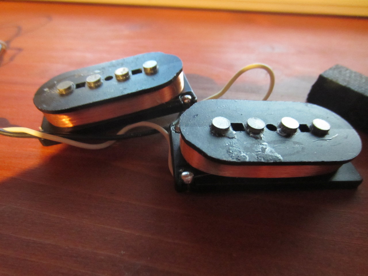

Der Tonerider ist aber vom Aufbau her anders. Der Spulenträger ist nicht oval und die Polepieces stehen ein wenig über ;) Absolut identisch sind sie nicht...

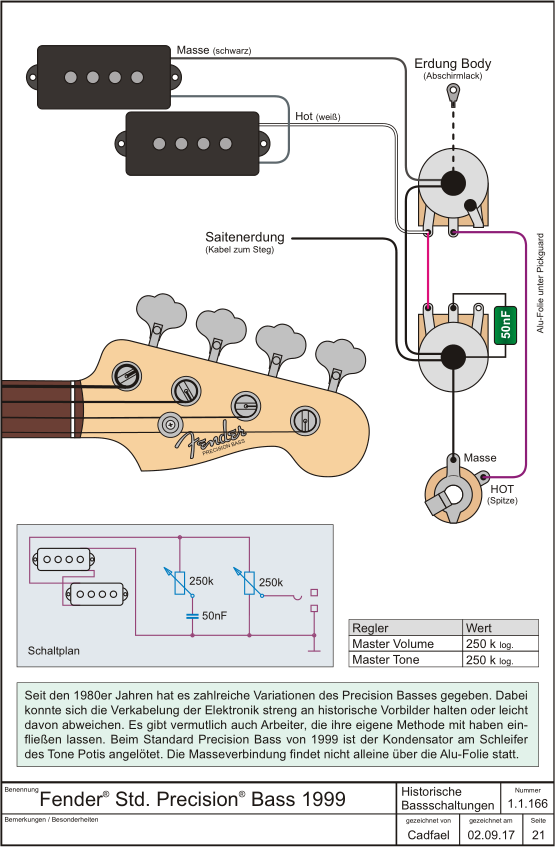

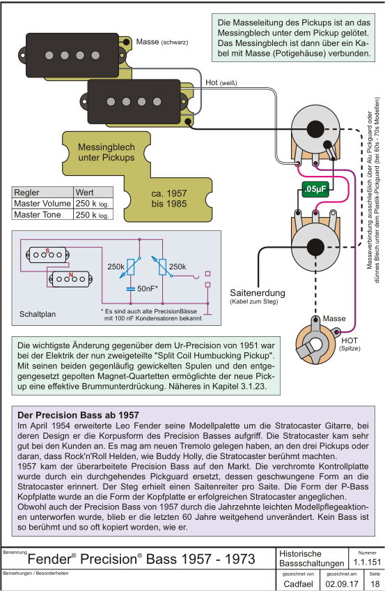

Das mit der Schaltungsänderung von Standard auf 57er hab ich noch nicht ganz verstanden. Diese Änderung soll den Sound verändert haben?
Um von gleichen Vorraussetzung auszugehen, nochmal die Schaltungen (laut Cadfael):
Ist das richtig so?
Reaktionen: mulhofa und cwegy
